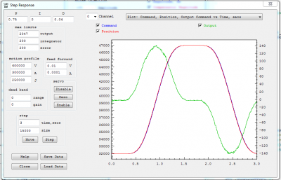

As a complete newbie in tuning servos, i need some help.
Wired it all up, have encoder feedback and can drive they with console and kmotioncnc.
With console i can get really high speeds.
I can't figure out how to tune it exact.
The servos have 8192pulses encoders.
Also they have one pulley and the ballscrew pitch. With about 16000pulses i could get it almost right in kmotionCNC (encoder distance and measured distance).
When I jog the machine, with slow jog all goes well, when i jog with fast jog, it goes some distance and hit the max following error.
Can you give me some help tuning these motors? Also, the encoder seems to be varying a bit, moving the dimension in kmotioncnc from 0.000 to 0.006 and back.
Thanks!!

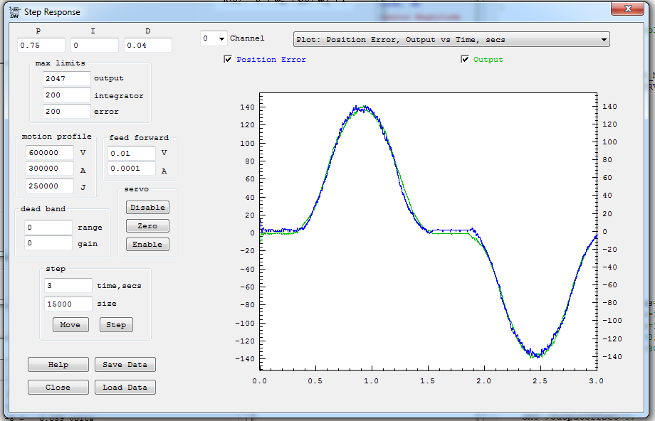

- Posts: 2955
Re: Wiring and configuration SERVO DRIVES

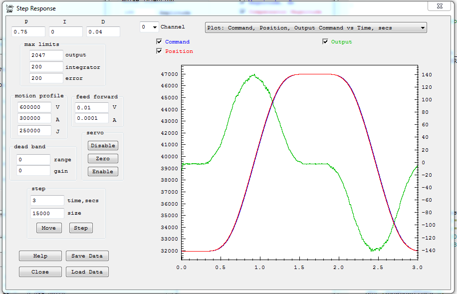

Hi Gabriel,
Encoder might be a little noisy. Hard to tell because you didn't post the raw data so we could zoom in. Do you have optical encoders?
D Gain is probably too small to be doing anything.
I prefer not using Feed Forward until feed back is tuned better .
Without any I gain, error limited to 200, and P Gain of 0.75 the servo is only allowed to output 200 x 0.75 = 150 DAC counts (~ 0.7V) so you won't be able to go very fast.
I don't understand your description of the axis resolution.
Have you tried to do the steps listed here?

Thanks for the reply Tom.
Yes, the drivers are yaskawa cacr-sr and have optical differential encoders.
If I don't use feed forward the position error read in the different position from the output.
I tried following the steps in the guide with no improvement. About the P, I can higher it till 1.1 where it starts some very strange movements. Maybe I will try to lower the speed and raise P?
I will try to change some settings and post the data.

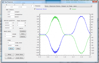

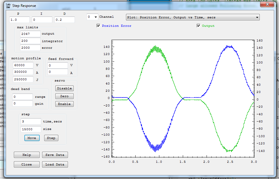

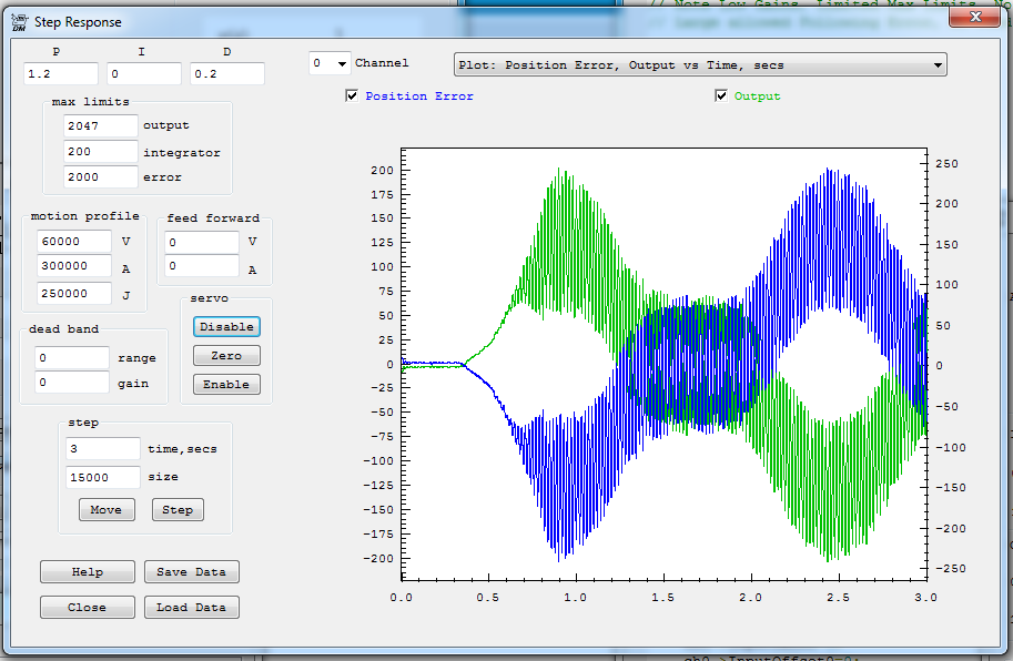

Tom, here goes both of the plots. with P1.2 (strange) and with P1( ok )
Changed some settings also.
I can't save data and upload as it is 1.4mb and the forum only accepts 1mb.

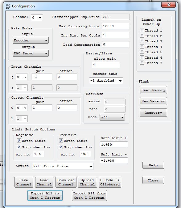

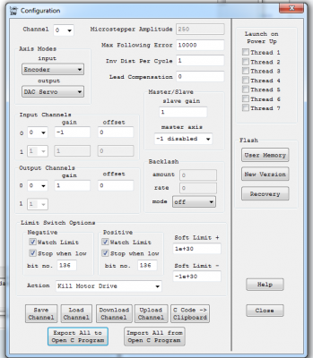

SETTINGS:
// Default Initial Configuration for 3 Axis Analog DAC Servo with encoder feedback
// Note Low Gains, Limited Max Limits, No Limit Options, No Soft Limits,
// Large allowed Following Error, No Feed Forward, No Filters, etc
//SetBit(152); // enable AMPS
//SetBit(157);
//SetBit(158);
ch0->InputMode=ENCODER_MODE;
ch0->Vel=60000;
ch0->Accel=300000;
ch0->Jerk=250000;
ch0->P=1;
ch0->I=0;
ch0->D=0.2;
ch0->FFAccel=0;
ch0->FFVel=0;
ch0->MaxI=200;
ch0->MaxErr=2000;
ch0->MaxOutput=2047;
ch0->DeadBandGain=0;
ch0->DeadBandRange=0;
ch0->InputChan0=0;
ch0->InputChan1=1;
ch0->OutputChan0=0;
ch0->OutputChan1=1;
ch0->MasterAxis=-1;
ch0->LimitSwitchOptions=0x10f;
ch0->LimitSwitchNegBit=136;
ch0->LimitSwitchPosBit=136;
ch0->SoftLimitPos=1e+30;
ch0->SoftLimitNeg=-1e+30;
ch0->InputGain0=-1;
ch0->InputGain1=1;
ch0->InputOffset0=0;
ch0->InputOffset1=0;
ch0->OutputGain=1;
ch0->OutputOffset=0;
ch0->SlaveGain=1;
ch0->BacklashAmount=0;
ch0->BacklashRate=0;
ch0->invDistPerCycle=1;
ch0->Lead=0;
ch0->MaxFollowingError=10000;
ch0->StepperAmplitude=250;
ch0->iir[0].B0=1;
ch0->iir[0].B1=0;
ch0->iir[0].B2=0;
ch0->iir[0].A1=0;
ch0->iir[0].A2=0;
ch0->iir[1].B0=1;
ch0->iir[1].B1=0;
ch0->iir[1].B2=0;
ch0->iir[1].A1=0;
ch0->iir[1].A2=0;

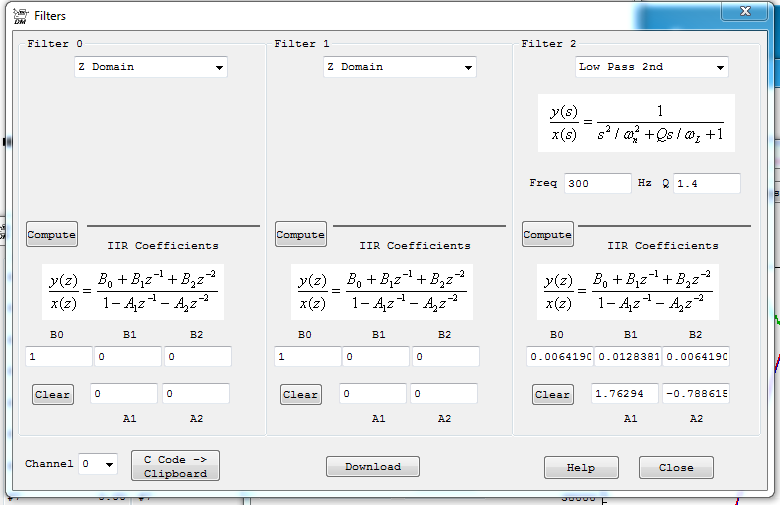

ch0->iir[2].B0=0.00641907;
ch0->iir[2].B1=0.0128381;
ch0->iir[2].B2=0.00641907;
ch0->iir[2].A1=1.76294;
ch0->iir[2].A2=-0.788615;
EnableAxis(0);
DefineCoordSystem(0,1,2,-1);

The next step would be to find max D gain and to see if it then allows higher P gain.
That is classically unstable.here goes both of the plots. with P1.2 (strange) and with P1( ok )
I don't believe our forum has a 1MByte limit. Did you try it? You can also collect less time or zip to create a smaller file.I can't save data and upload as it is 1.4mb and the forum only accepts 1mb.

Tom, after the last changes the machine run much better and has no problem moving or losing dimensions.
