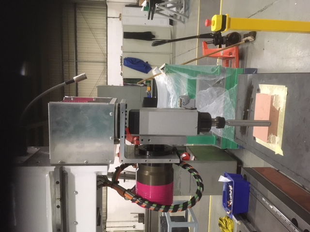

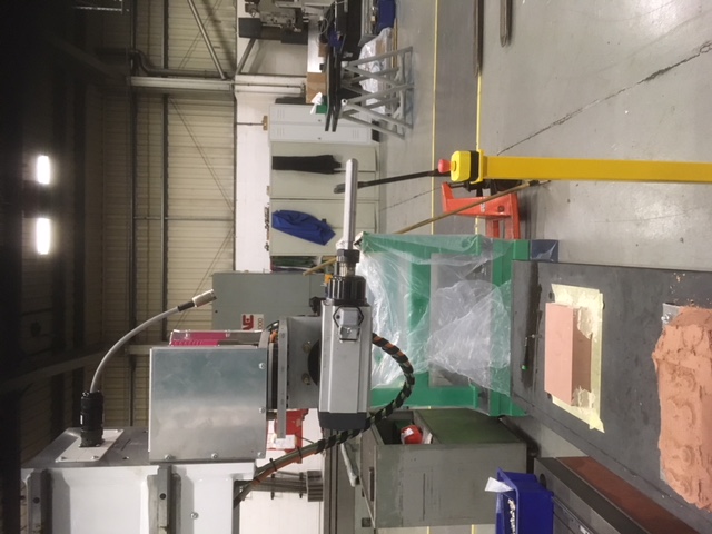

I attach 2 pictures of our re-configured 5 axis head.
The spindle centre line is now in line with the C rotation.
There is now only 1 pivot length which is A axis centre of rotation to spindle collet = 0 tool length.
In the pictures the X linear axis is +ve into the photo towards the cabinets.
The Y linear axis is +ve to the left side of the photo and the Z linear axis is +ve vertically up.
Picture 1 shows the A0 C0 poisition.
Picture 2 shows the A90 C90 position = cw +ve rotations about the X and Z axis when viewed down the +ve linear axis direction.
No Kinematics .txt file causes independent linear and rotational axis jogs.
Kinematics.txt with the line Kinematics5AxisGimbalAB causes what i think are RTCP jog moves but i think either the linear axes
are moving in the wrong directions, or the rotational axes are moving in the wrong directions as the tool tip centre moves
away from the RTCP centre.
Can you please offer help ?
Tim

Hi Tim,
I think the A axis is rotating the wrong direction. I think the tool should follow the right hand rule. Point your thumb in the +X direction then moving A + should rotate in the direction of your fingers. Your example of moving from 0 to +90 seems to be opposite this. Try reversing the A axis in the KFLOP axis settings (Output Gain and Input gain if there is feedback).
