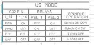

I have the following table from my c68 docs (labeled "c32 pins", which I assume are the same as my board) that confuses me, but perhaps you can make sense of it for me:
Do I take this to indicate Bob pin 1-14 (either IO27 or IO38) in pwm mode will switch relay 1 or relay 2 on/off PLUS set the PWM duty cycle depending on the state of pin 1-16? If pin 1-14 is at a very low duty cycle, could it trip either relay?

Regarding the CNC4PC Table: I think that is just explaining how the Direction bit controls which relay will come on when there is some PWM activity. And that if there is no PWM activity then both relays will automatically be off regardless of the direction.
