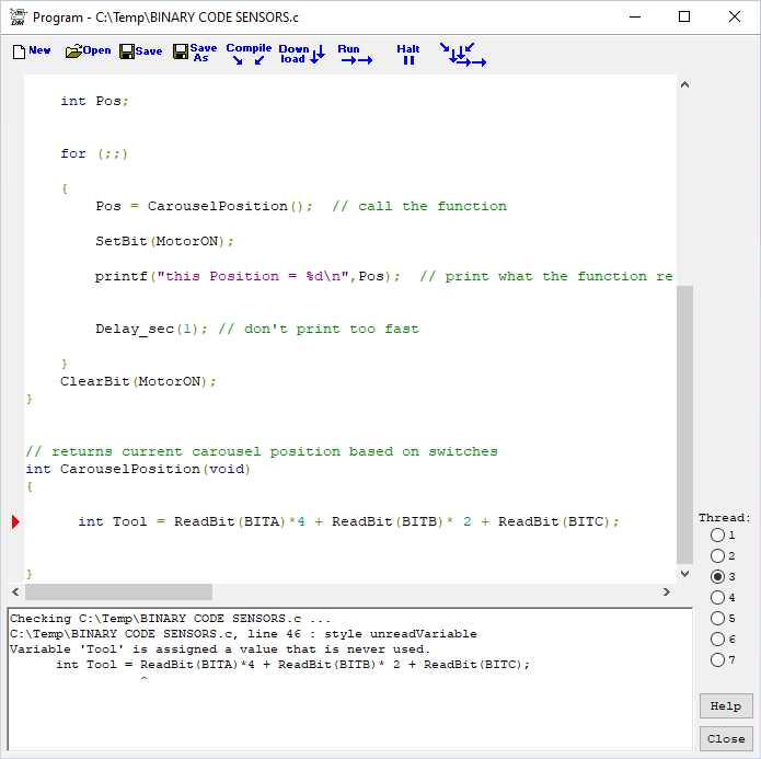

Ah. I see in CarouselPosition you aren't returning the result. If you would have followed my advice the Validator would have warned you of this:
btw 3 bit binary will be 0 to 7. To have 1 to 8 add 1.
