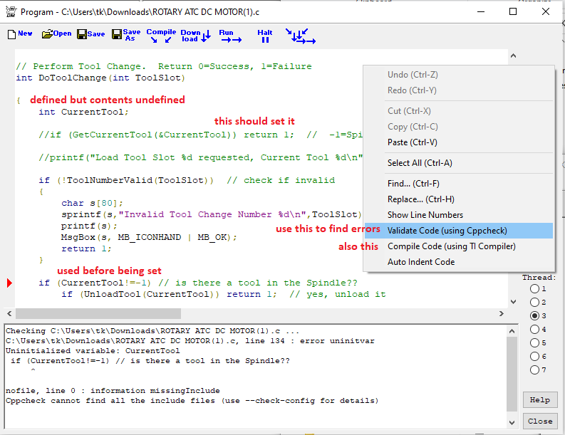

Tooltopickup() returns the current position of the carousel 1 through 8. Why did you change the name from 'CarouselPosition' to 'Tooltopockup'? It doesn't make sense to the carousel position to the ReadBit function as a bit number to read. If the Carousel is currently at position 5 why read bit 5?
Instead wait until Tooltopickup() (or properly named CarouselPosition) equals the requested tool number which has been passed in variable 'Tool'
You might have noted that the requested tool number 'Tool' was not being used so it couldn't possibly stop at the requested tool.
I'm not sure how the tool position switches work but I would expect that halfway between positions no switch will be activated. I had CarouselPosition() returning -1 in that case. You removed that. In that case with nothing specified to return the value might be anything and the results unpredictable. I would put that back in.
I also see CurrentTool is used but never determined. See below:
