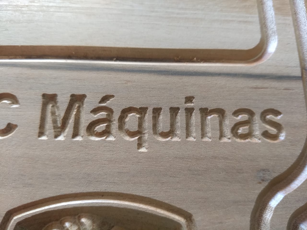

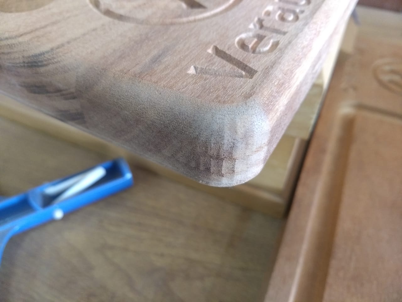

While moving a single axis it works nice.
While interpolating X and Y in some places it make corners wrong.
While engraving it's a disaster.
Tried many and many and many configurations. (more D gain, more I gain, more P gain) also less gain in all configs.
I'm losing hope

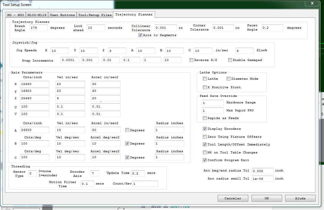

One issue I see is your tuning is mostly relying on Velocity Feed Forward to create the 1200 DAC counts of output. The Integrator gain is low and the limit of 100 DAC counts prevents it from doing much. Feed forward is like driving blind folded. If the road is perfect and you anticipate corners perfectly then you can stay on the road. But if conditions change, or there are external disturbances to push you off the road, you won't do very well (cutting forces).
On the other hand, the Max Following error is set at 100 encoder counts. This means the servo errors never exceed 100 encoder counts. Which is:
100/15880 = 0.0063 inches = 0.16mm
Which is about the thickness of a piece of paper. Your errors seem larger than this. So that would indicate something mechanical such as lead screw backlash or other mechanical compliance or resonance.
The Step Response Plots only show errors of ~15 encoder counts. You might reduce the Max Following error to find the lowest value where you can still run GCode and cut wood without faulting.
The example CaptureXYZPosDestToFile.c can be used to capture data while running GCode to see exactly what trajectory is being commanded and how well the servo is performing. It can be assigned to an MCode (execute only without waiting) to start capturing data just before an area of interest. Then you can analyze the captured data with something like Excel.
But I suspect you have mechanical problems. Do you have a dial gauge? If so, measure the table relative to the Spindle and make small moves while changing direction to check for backlash or compliance. Also push on the Spindle and measure any deflection.
Please post a GCode fragment that shows the problem.

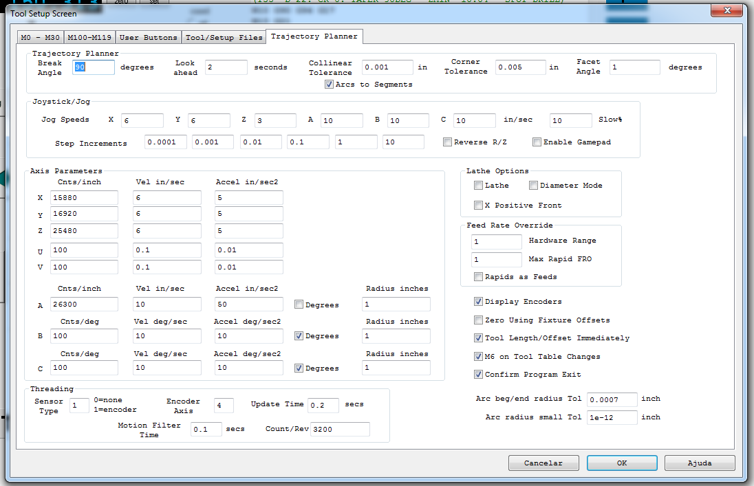

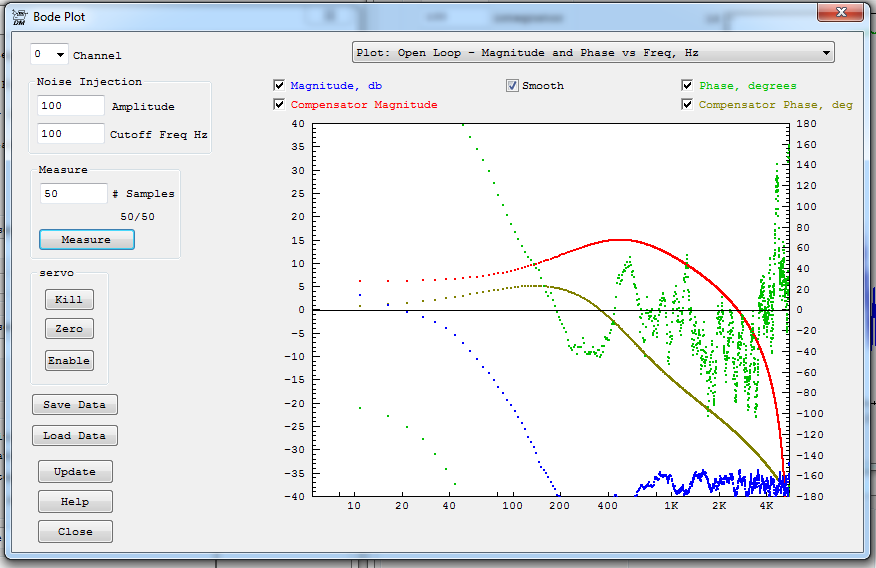

Below a photo with the tips that you posted above about I and D. (It works great, no plot because machine is off, soon will post plot)

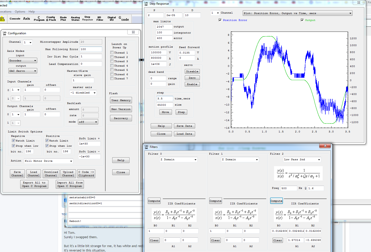

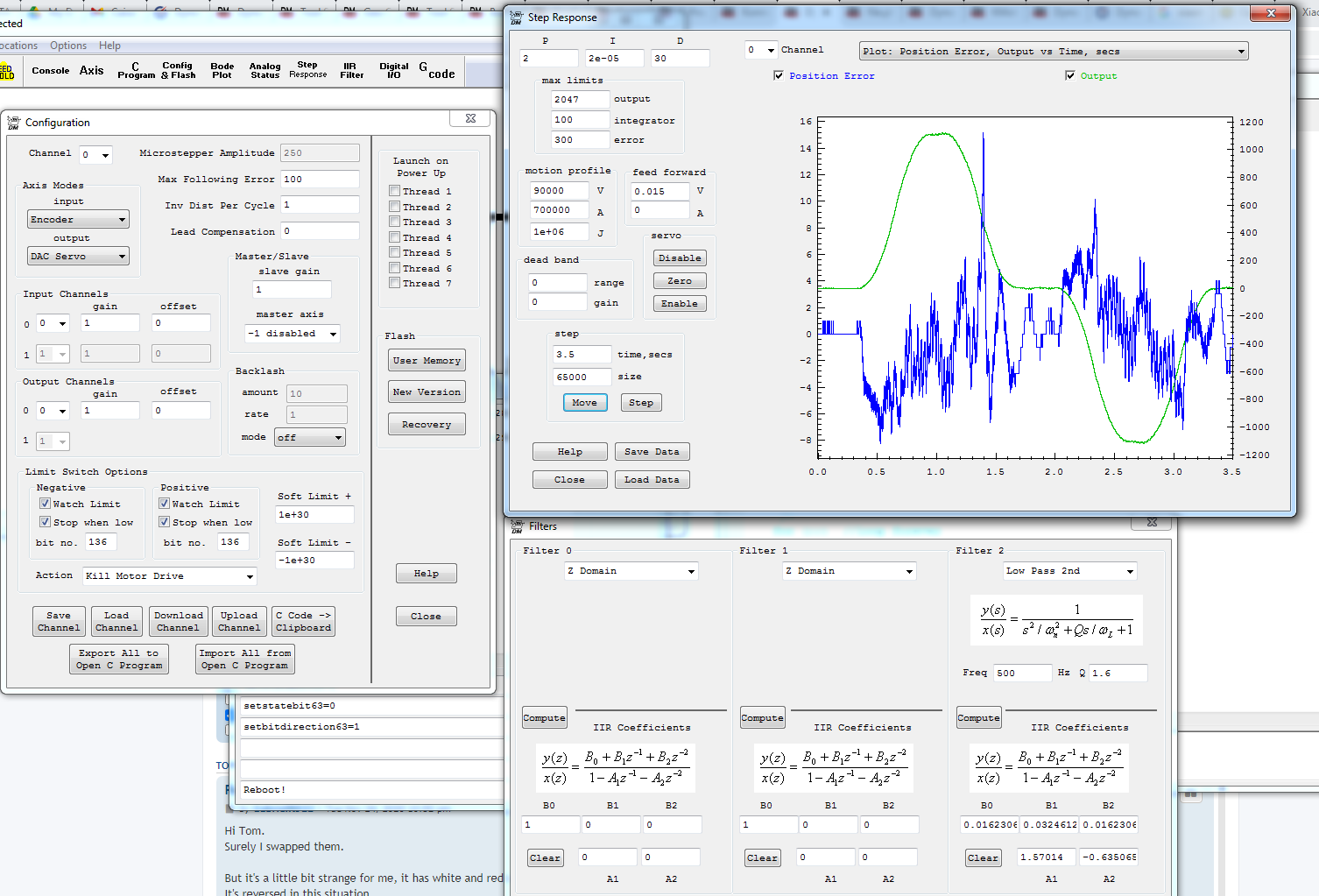

I tuned the Y servo, but if i use more than D10 it gives some unstability at a speed of ~5m/min
no unstability in the plot screen.
attached are the info.
Thanks Tom.

- Posts: 2891
Re: Wiring and configuration SERVO DRIVES
Hi Gabriel,
Its not clear what you are asking.
You didn't include your Step Response Screen settings.
Have you tried tuning? What have you tried?
