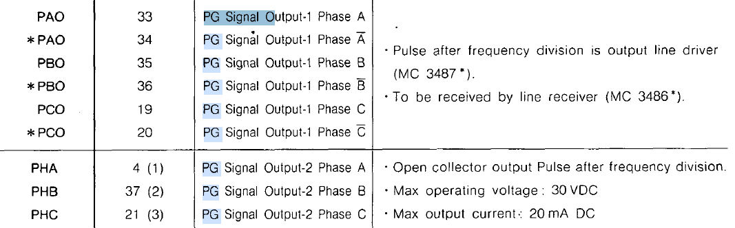

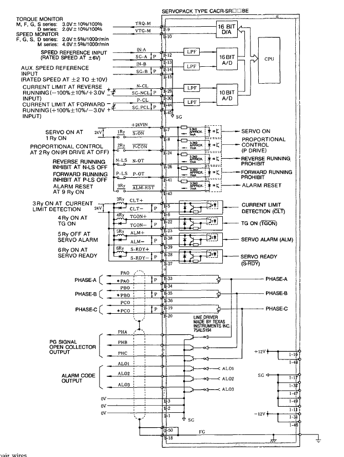

Looking to the drive schematic, it seems that the 0v is used to open collector use. Look this wiring below, it shows it also.

No, the schematic shows the differential drivers and the open collectors use the same ground reference.Looking to the drive schematic, it seems that the 0v is used to open collector use.

Surely I wan't to figure it out, but i don't think a configuration that worked for 25 years is wrong. Maybe it's not compatible with Kanalog or the NUM CNC did something inside the cnc with the 0V?
The drive have SGB and INB that are the inputs for speed reference.
This are connected do DAC(INB) and DAC GND(SGB).
The Encoder is connected to the drive with A+ A- B+ B- C+ B- / 0V and 5V
The drive is grounded
The encoder output from the drive is connected to A+ A- B+ B-.
The drive also has a 0V output from the encoder.

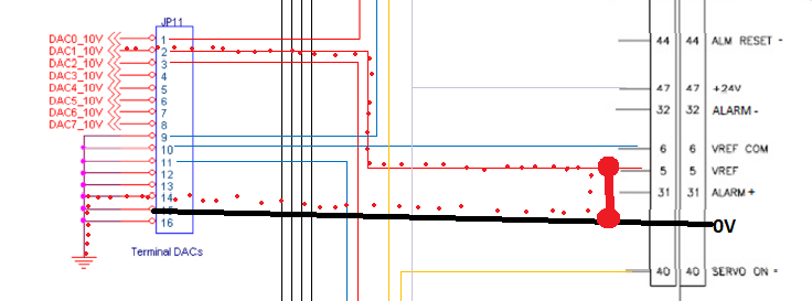

That would indicate a short between INB and 0V as shown in red below. The red-dot path would be the cause of the DAC being forced to 0V.Ground (JP6 ground) the 0V from the drive encoder output.
The DAC output goes to 0.
With power off what is the measured resistance between the DAC wire and 0V?

The resistance is 4M 0V and GND
But its short with the dac + signal. maybe i need to invert DAC + and - ?
The + is red.
If i disconnect the connector from the drive, it dont short.
So the short is inside the drive.
with no power.
The + is red.
