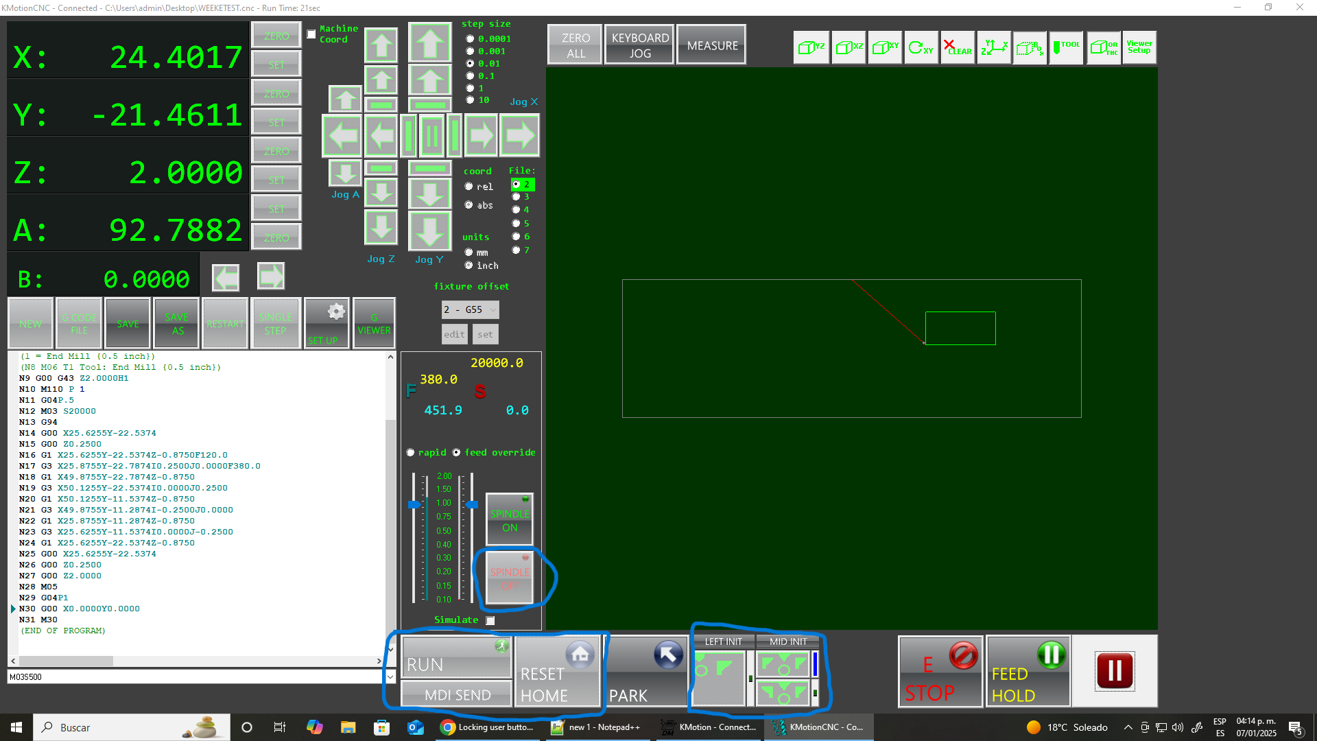

I am designing a new custom screen interface for a cnc router, i need to add some new user buttons and i would like to make them, light up or change their color when be active, like toggle button but some of em will be momentary just push and keep light on, and turn off when push other button, also some buttons add some blinking e.g like the Init button blinking from green to red or E stop button blinking from red to yellow, as well be able to control the buttons status from c, program.

Hi Noel,
Here is an example using Screen Script to change the background color of text Button from Red to Green:
You would probably want to use a state machine approach in your forever loop in Thread #1 to do multiple things at the same time.
KFLOP commands are only updated on status requests that occur ~ 10 times/second so you wouldn't want to send too may commands.
To change colors of buttons with bitmaps you would need to create bitmaps with different colors.

Yes, I have created some bitmap buttons, also i need that some buttons be disabled when running G code like jog buttons, how can do that,

Hi Noel,
Basically to blink a button set the button to color #1 then set a state variable to 1, record the time, and exit.
if in state 1 check if the desired time has elapsed, if not exit, if so, set to color #2, set the state variable to 2, record the time and exit.
if in state 2 check if the desired time has elapsed, if not exit, if so, set to color #1, set the state variable to 1, record the time and exit.
You might read this.i need that some buttons be disabled when running G code like jog buttons, how can do that,
You might read this wiki article.You would probably want to use a state machine approach in your forever loop in Thread #1 to do multiple things at the same time.
Thank you Tom,
it's working now, i have some buttons locked up while running G code.
