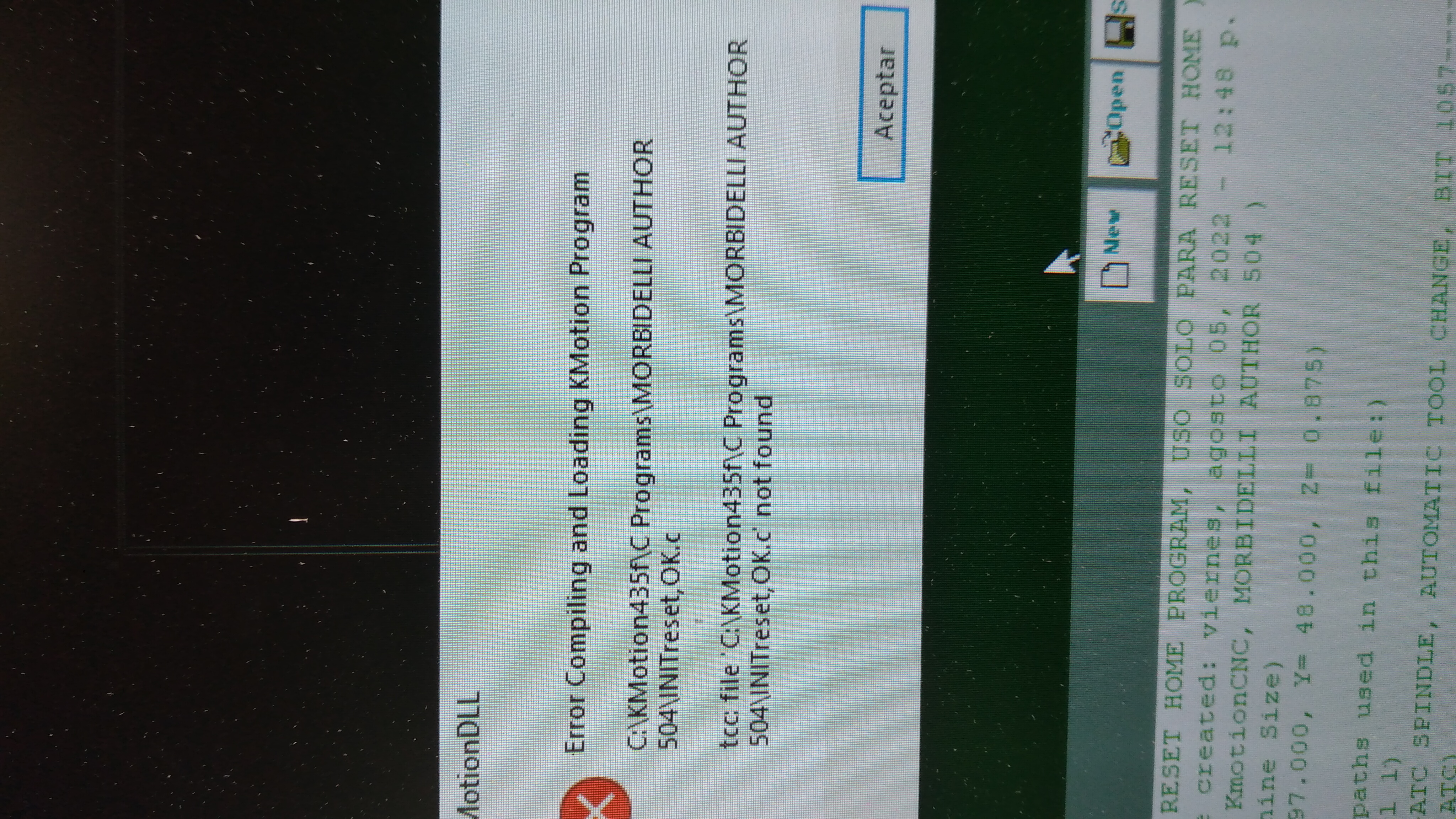

I found this problem this morning I don't have any idea what happened, looks like it lost all parameters, how can i solve it.
- Posts: 2913
Looks like "reset,OK" got entered into the INIT filename. How is the button configured?
Reset ok is the c program i have configured with the reset button to initialize, everything was working fine, days ago i saved the configuration to a usb memory and today i found that, the pc was not been used since that day, now is working but i had to uninstall the software and install it again. Where is saved all data for tool setup located? I had to enter by hand all parameters, fortunately i had screenshots of all information.

Tom i found this post, maybe this happen to my controller?, i had a back up of my folders, maybe i moved instead of copied something?, also i did replaced the Data folder, so looks like it was the problem.
