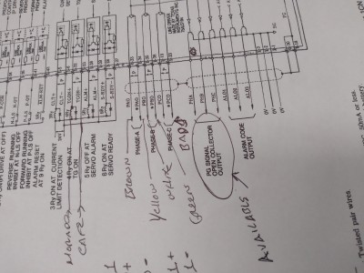

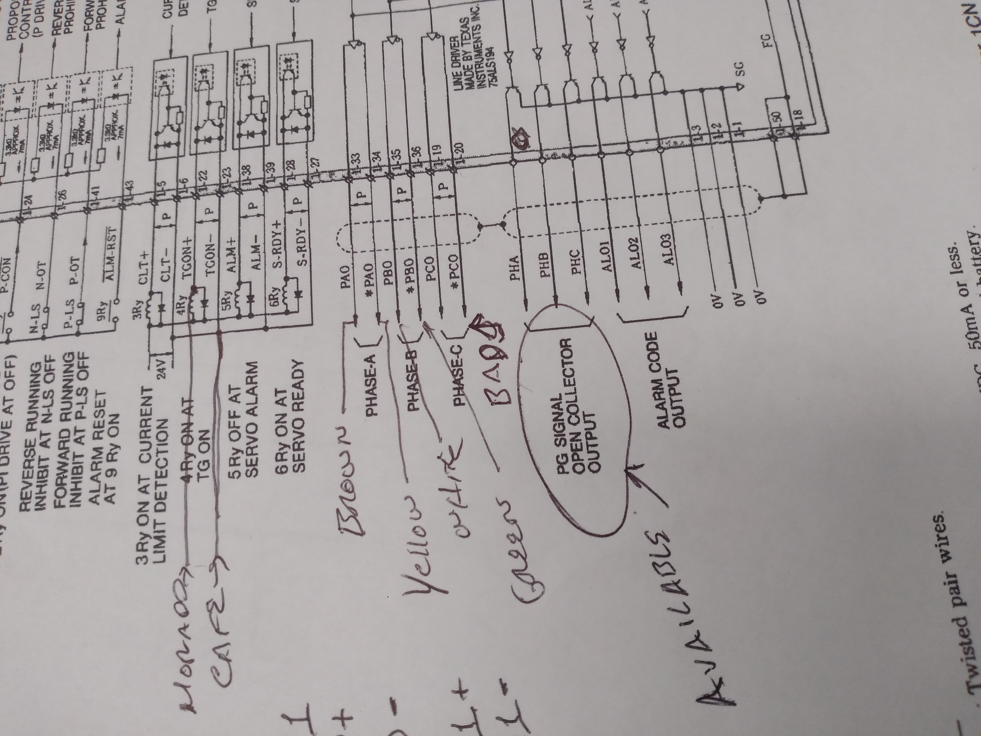

I found a problem inside the Y axis Driver, it does not send encoder signal to Kanalog, i tested the encoder with an other drive and works fine, looks like the outputs PA0 PB0 are bad, there are other open collector outputs available can i use these? What do you think?
Posts: 2913
Post by TomKerekes » Thu May 26, 2022 5:57 pm
Kanalog requires differential signals. I suppose you could add an external 3rd party differential Driver such as this. You would also need a pull up resistor to +5V on the open collector outputs. Or use a pull up resistor and connect directly to KFLOP's single ended encoder inputs on KFLOP JP5. Open collector outputs are not as fast as differential signals and are more susceptible to noise.

Ok, well i opened the drive and found a 74LS07 chip blowed out so i will try to replace it.
