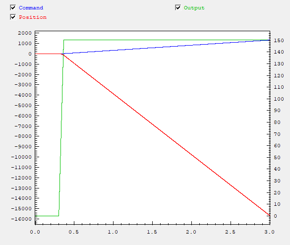

Post by NOELNOG » Tue May 24, 2022 3:07 am
servotuningtest1ok.zip
(370.52 KiB) Downloaded 127 times
this is the step resonse screen, hope it can help,
thanks

Post by TomKerekes » Tue May 24, 2022 4:38 pm
Can you see the motor is driving the wrong way? Command goes positive axis goes negative. See here.

Post by NOELNOG » Tue May 24, 2022 5:35 pm
oh i understand now why when i press the move button in the step response screen the axis drive opposite direction to jog buttons.
so that's why the error is going bigger and bigger instead smaller.
i inverted the wires because the direction was opposite to the tool graphic in the screen, and the jog buttons, so i just have to adjust something in the KmotionCNC to match the grapghic tool direction as well the jog buttons,
