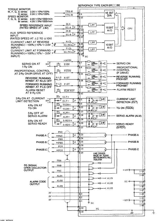

Hello Tom
I am trying to test my servo motors before connect them to kanalog just to make sure they are ok, my drives are turned on, first they show Base Block "BB", then i apply signal in S-ON input and the drives turn to Run mode and motor locks wich is normal and ready to rotate, but i am giving 5v+ in the signal inputs to try to rotate it and doesn't move, they are analog +10v Yaskawa CACR-SR15BE12G-C, i am a little confusing with the analog input signals, manual explanation show potenntiometer and resistors, is any other easy way to test them or do i have to build that circuit?
also i am confusing with the velocity mode, position mode, torque mode, which one do i need on my cnc router?, i assume it's position right? so the drives should me already configured that mode since they are the original system.
thanks
Posts: 2913
Post by TomKerekes » Fri May 13, 2022 2:13 pm
See Testing Analog Amplifiers.
Apply the Voltage to the Speed Reference Input or Aux Speed Reference Input. Not sure why one says +/-6V not +/- 10V.
Normally Velocity mode is the simplest mode for tuning.
NOELNOG
Posts: 178
Joined: Wed Nov 10, 2021 3:54 pm
Post by NOELNOG » Fri May 13, 2022 2:40 pm
I have noted that the motor it's not locked at all, it's rotating very very slow even without input signals and if i try to rotate it by hand i can twist it in both directions a little bit then it return to its position like a coil spring but it still moving very slow in one direction. it's is that normal?
Posts: 2913
Post by TomKerekes » Fri May 13, 2022 2:56 pm
See Axis Drift with Servo Disabled
The behavior you describe doesn't seem like velocity mode. Velocity mode may drift and resist motion (drag) but should not spring back.
