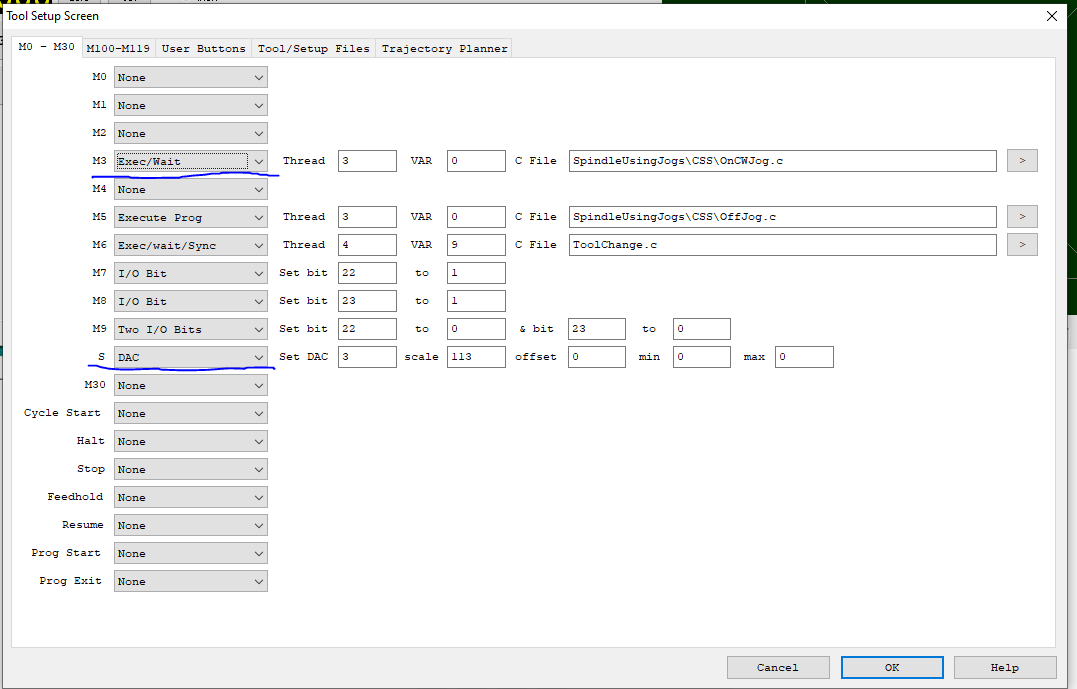

When you config your M3 Program in the Tool Setup Screen, select Exec/Wait and then select your program.
This will make the system wait for the program to end execution before continue the code.
Also, you can simplify your code.
SetBit(SPINDLECW_BIT); // This will turn your spindle on
Delay_sec(SPINDLE_RAMP_DELAY); // this will allow time for it to ramp up.
For the speed, you need to configure the "S", below M9 in the same page as before.
You will choose DAC and then input the parameters.
Take care with a open system loop. If you have the spindle turned on with CCW and turn it on in CW, it can cause you problems.
Also you should have at least a check if the spindle is on or not.

noAre you saying that using Execute/Wait somehow causes the Delay_Sec() to be active?
yesMaybe it causes the calling routing to wait until the OnCWJog.c routine finishes?
Whenever an action is configured as Execute/wait the Interpreter Executes the C Program and waits for it to finish before going on to the next line of GCode.Either way, what causes the motion to pause?
The C Program should not terminate until it is ok for the GCode program to continue. If a time delay works for this add a time delay.Is that something that has to be added in OnCWJog.c?

Thanks Tom, that now works as expected in Run, Single Step and just manually turning the spindle on and off.
