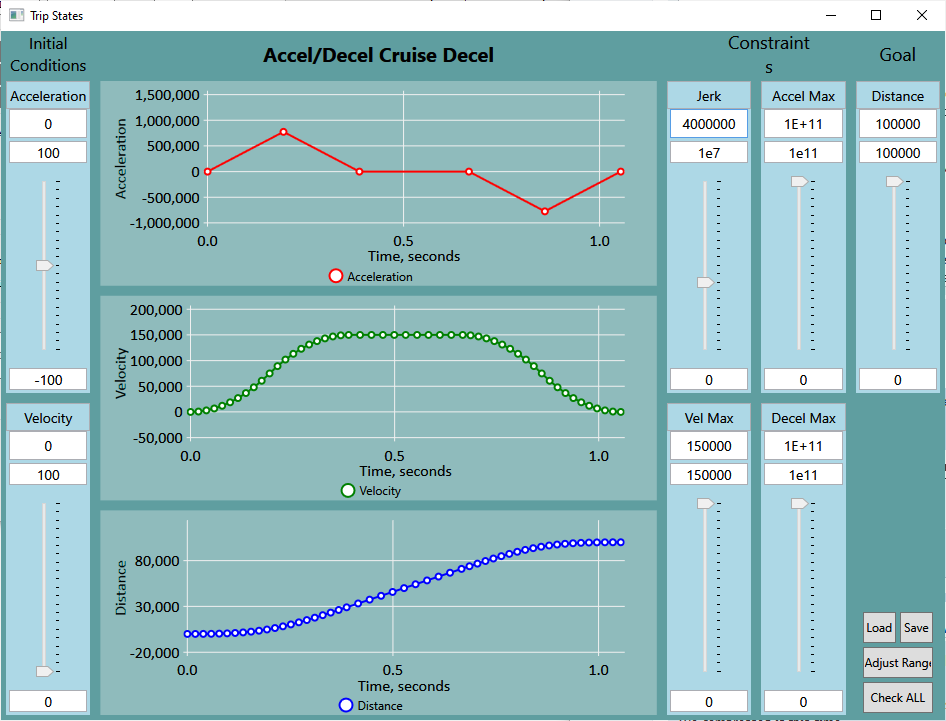

The reason the acceleration is not increasing is because the motion is Jerk and velocity limited. Jerk is the rate Acceleration is applied. Imagine your in a car and are told you can only very slowly apply acceleration and are told to drive 30mph. After reaching 15mph with the accelerator only slightly depressed (ignoring friction) you will need to start releasing the acceleration otherwise the 30mph limit will be exceeded before you can get off the gas.
There is a program included with KMotion called TripsWPF.exe that can help you better understand Jerk, Acceleration, Velocity, and Distance. You might watch the related video.
Here is TripsWPF with your parameters entered. Notice the Acceleration ramps up to ~ 750,000 but then must begin to ramp down:

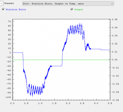

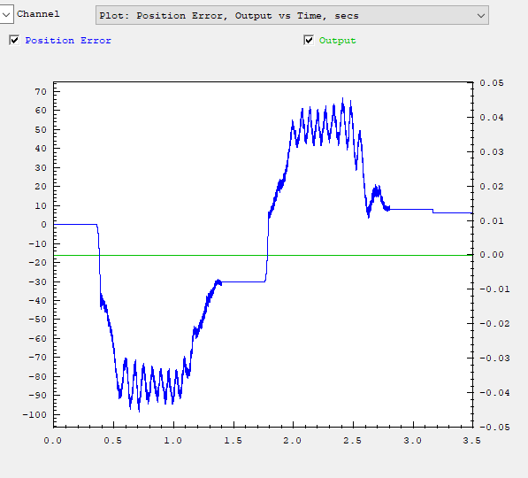

Anyway, here is the data with the feed forward set to zero.
Good. Here is the error plot that the linear scales are seeing with an open loop move (from KFLOP's perspective based on the linear scales). Max errors are ~90 steps (45um) when moving and ~30 steps (15um) when stopped
I don't understand why the output is now a straight line. What does the Output represent?
Because the PID gains and FF gains are all zero no corrections are being made. So the output is always zero. The Output (using the right side scale) indicates how much correction is being made in motor steps.
The next step would be to add PID gains, Low Pass filter, or FF gains to see if you can reduce the errors. Usually a small amount of I gain (ie 0.001) is most useful.

The motion profile acceleration figure doesn't seem to affect the Command curve beyond A=1e6 When I set it above that, the steepness of the Command curve doen't increase. I don't think this is stretching the AC Servo acceleration performance to the limit.
As I tried to explain above you will need to increase Jerk or Velocity to ever reach higher acceleration. A normal setting for Jerk is 10X the Acceleration so the full Acceleration is applied over 0.1 seconds. Not 7hrs as the current parameters :)
