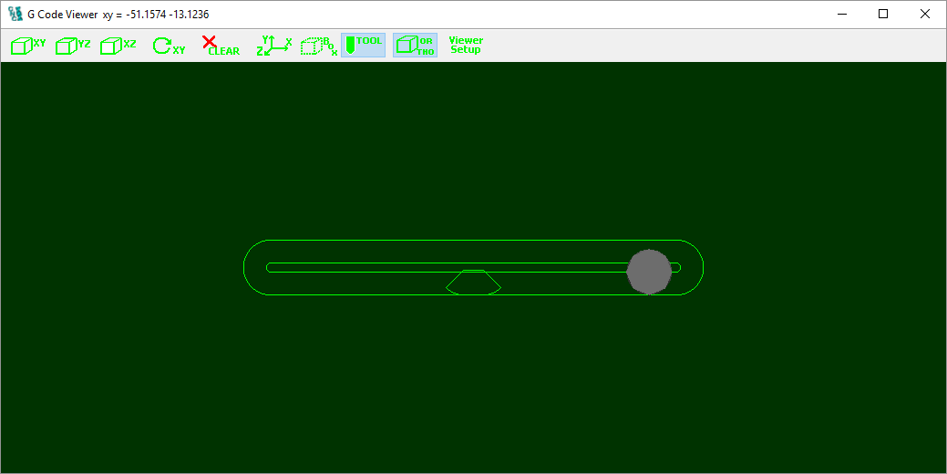

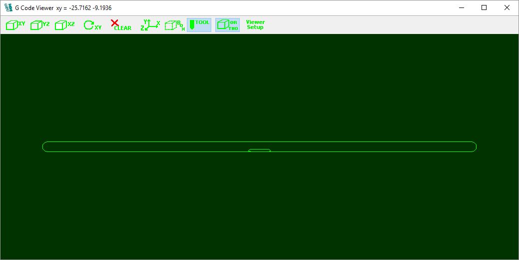

The radius compensation seems to work ok for me. Here is a tool path plot of your GCode with comp for a 5mm diameter Tool.
with comp.png (7.36 KiB) Viewed 15671 times
Here is a double plot with/without compensation. "Without" comp was created by setting the Tool diameter to 0.001mm (Tool image diameter is still 5mm)
I've also attached the Settings file (as a txt file) that was used.

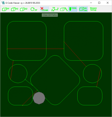

It isn't clear to me what you are trying to do. Are you trying to cut pockets or leave material standing up.
Here is a plot of the GCode with no compensation which should show how the material should look after the Job runs.
Also shown is a tool with diameter 12.72mm.
If you are trying to cut pockets the tool is too big to fit in radius.
If you are trying to leave standing material the tool will gouge the adjacent material.
What are you trying to do?

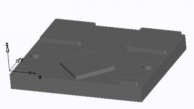

a_j_p
Posts: 18
Joined: Sun Aug 26, 2018 10:13 pm
Re: Fanuc Radius Compensation
Post by a_j_p » Mon Sep 24, 2018 7:24 pm
I am trying to cut bosses, the first image attached called 'boss outline and setup' should hopefully explain. The second picture called 'centerline' is a centerline simulation in the software I use (FeatureCAM) showing the finish pass (same as the G Code I posted earlier) but it also includes a wireframe outline of the tool, which does not gouge any adjacent material...
I have not used cutter compensation before now, I have not had the need to do so until recently, so it very well could be something I am doing wrong but I have been trying to figure it out for a while now without much success. It is pretty difficult however to get the FeatureCAM guys to support when the machine is not something that has a manufacturer's manual they can follow along to make post processor adjustments. The post I have from them is based on a Fanuc system with only small changes to add custom M Codes that I can have KMotionCNC execute specific items with.
If it helps at all, below is the same file's G Code post with cutter compensation turned off in FeatureCAM. I have used this file to run a part and it works just fine, just without the cutter comp...
Again I appreciate the help! Let me know if there is anything more I can provide, etc.
Posts: 2901
Post by TomKerekes » Mon Sep 24, 2018 8:21 pm
Hi a_j_p,
Thanks for the information.
It seems the specified paths in your GCode in both cases (with and without compensation) is exactly the same.
Maybe the confusion is that there are basically 2 approaches to Tool Diameter Compensation.
#1 - is where the GCode specifies the final result without any compensation at all. In this case the Tool Table entry contains the true Tool Diameter of the tool and the GCode Interpreter does all the compensation.
#2 - is where the CAM software does all the compensation and specifies in the GCode the tool path based on a theoretical tool diameter. In this case the Tool Table entry contains a small +/- difference between the actual tool diameter and the theoretical tool diameter used by the CAM. The GCode Interpreter then makes only a small adjustment to the tool path to compensate.
Do you understand the difference? Which approach are you intending to use?
a_j_p
Posts: 18
Post by a_j_p » Mon Sep 24, 2018 9:16 pm
Hey Tom,
I was planning (at least in my head it seemed the easiest) to have the CAM software setup with the theoretical/nominal tool diameter and specify the end result. The Tool Table would contain the actual tool diameter and the GCode interpreter would offset itself half the distance of the diameter in the tool table to yield that end result.
If I understand what you have written correctly, I believe this would be your option #1.
Is that not what I am doing?
Again, thanks for the help!
