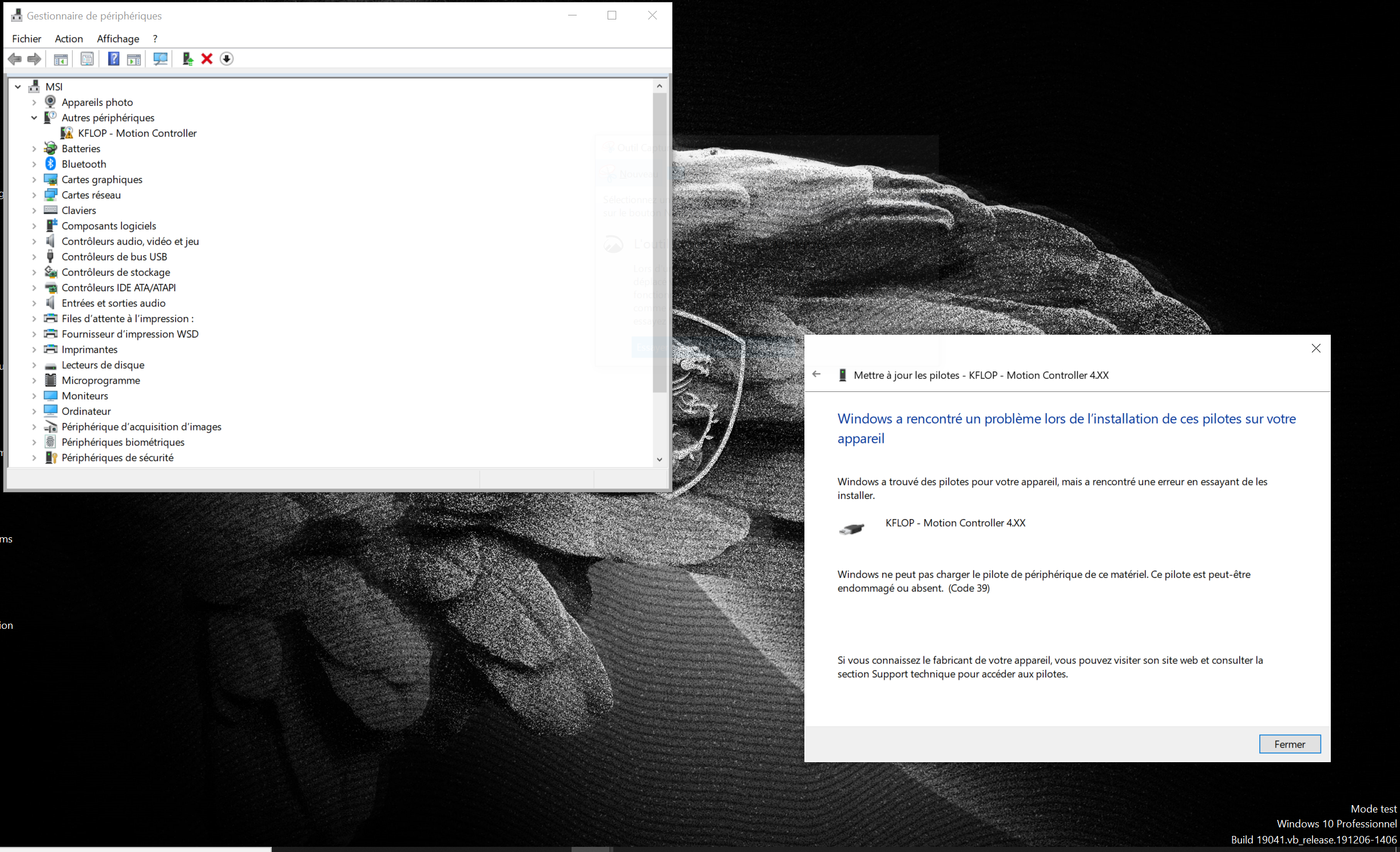

Hello,
I have a problem with Kflop driver installation.
Windows 10 is saying "Windows Encountered a Problem Installing the Driver Software for your Device".
"The hash for the file is not present in the specified catalog file. The file is likely corrupt or the victim of tampering."
Do you have a solution?
Playing with registry forced me to reinicialiser Windows.
Now it its the same.
Thank you,
have a nice day,
Evgeny
problem capture

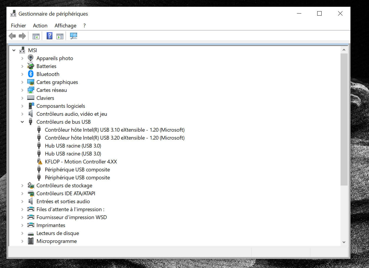

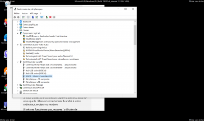

Update,
the probleme seems with signatures of drivers,
partially helped these advises
http://www.hackaapl.com/trouble-install ... r-signing/
I need to restart Windows in "Safe mode".
In this mode installation of driver was succesfull, BUT
when I start Windows normally still some problem with driver.
Please help.
Thank you.
normal mode
safe mode
