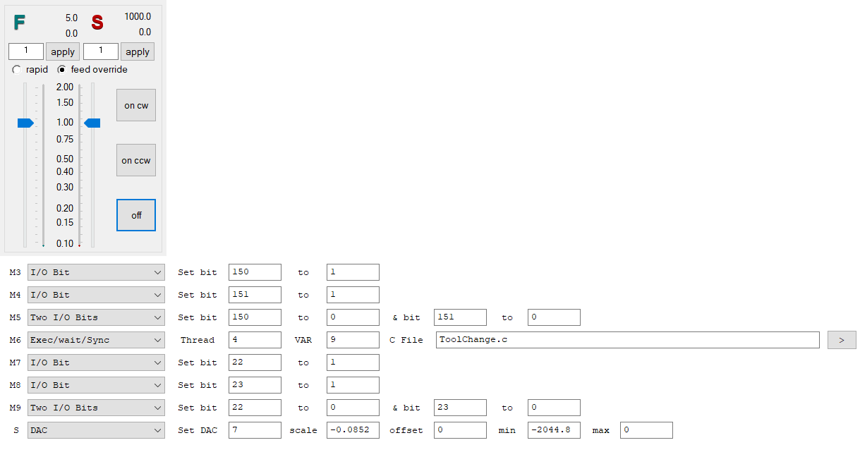

This is a pic of my settings in kmotioncnc. My C program that I am running does initialize my 7th axis with the settings that the setup instructions asked for.

The Spindle instructions describe two different methods to control the Spindle. A Basic method where no C Programs (and no KFLOP Axis) are required where the KMotionCNC S command simply sets a DAC. Or a method involving C Programs (and a KFLOP Axis) where KMotionCNC S commands are sent to a KFLOP C Program which in turn commands a KFLOP Axis to Jog which in turn commands the Spindle DAC. There are a number of advantages with the second method including the ability to gradually ramp the Velocity up/down to speed using a set acceleration.
You should pick one method or the other. You seem to be mixing both methods. I think because you have a KFLOP Axis controlling the Spindle's DAC when KMotionCNC writes to the DAC it is basically ignored as the KFLOP Axis immediately overwrites it.
