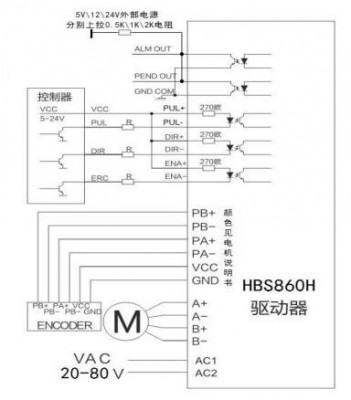

This drawing is all i found for the driver. Does this mean I use a digital ground pin for ALARM- and use a general purpose 5v tolerant like IO2 for ALARM+, then under limit switch options>>under positive>> i select bit no. 2
Drawing also shows it may need a resistor or maybe not!
Please correct me dunno how to do it.
- Posts: 2676
Re: Stepper Hybrid - JP7 vs JP5
That should work.This drawing is all i found for the driver. Does this mean I use a digital ground pin for ALARM- and use a general purpose 5v tolerant like IO2 for ALARM+
No this is an Alarm not a Limit switch. Your C Program should monitor the Input and do something such as disable all axes when it occurs.then under limit switch options>>under positive>> i select bit no. 2
Yes you will need a pull up resistor. Even with 5V tolerant pins pulling above 3.8V should be avoided. I'd use a 470 Ohm pull up to 3.3V.Drawing also shows it may need a resistor or maybe not!
Note connecting the GND COM to KFLOP GND will likely defeat the opto isolation between KFLOP and the Drive. It would be better to connect through an Opto Isolated Input such as provided by our Konnect board or other device.
