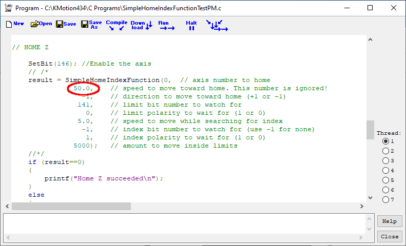

I'm running the SimpleHomeIndexFunctionTest in KMotion. It is as original except for a few minor changes I have made:-
1. Remmed out the X & Y sections so I only have to deal with one axis at a time
2. Reduced the axis travel speed
3. Changed the Limit Switch Bit to watch for
When I operate the Save, Compile, Download and Run button (or the separate ones - it makes no difference), the program seems to compile without issues and proceeds to run. This is evidenced by the tick appearing in the Enable tick box and the Destination display counting in the Axis window.
The first issue I'm having is that the Halt button does not stop the program. The only (nice) way I've found to do that is to click on the ticked Enable box. This removes the tick and the Dest display stops counting, so I presume that is stopping it?
The second issue is that the drive is not actually enabled (presumably since I have yet to discover where to tell the system which Bit is the drive enable output), and consequently the motor does not move.

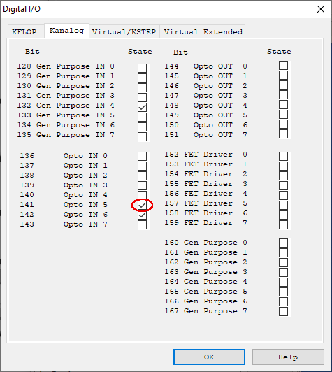

The drive enable Bit is 145 and so I can switch it on using the Dig I/O window. However, doing this doesn't change any of the above - the program still does not drive the motor. Once this is on, I can happily control the motor using Console commands (see screenshot) as expected.

What speed setting are you changing?hatcat wrote: ↑Tue Dec 29, 2020 10:25 am
The motor is responding to the program now, but only in a very limited way. It seems (largely at least) to ignore the speed and direction settings set in the program for whatever reason! The original speed setting was way too fast for getting things set up and working correctly so I reduced it. Still too fast for my liking, so I reduced it more. I reduced it from 1000 down to 5, doing a Save/Compile/Download/Run each time and it didn't make any difference to the speed the motor was running at.
By playing around with commands from the Console window, I worked out that the motor drive was getting a signal equivalent to a speed value of 200, so I started looking for where that could be coming from. I found that the MaxOutput was specified at 200, so that then made perfect sense for the values larger than 200, but what about the smaller ones? I found that I could control the motor speed by adjusting the value of this setting.
I pretty soon realised that the direction sign made no difference either - it just kept going in the same direction regardless. It will sometimes change direction and speed after a hardware power cycle, but not reliably even after hours of power off completely.
As you're using Servos, the MaxOutput refers to the maximum voltage the analogue DAC output can go to. Depending on if your servo drives work in speed or torque mode, commanding a DAC of 200 will either produce a fixed speed (in the case of speed mode), or a fixed torque (torque mode) which if the motor has little load, will result in it moving at high speed.
Are you sure you're monitoring the correct bit in the homing program?The next issue is that the Home finding part of the program doesn't work at the moment either. Once I got the speed down to something I could cope with, I let it have a go at the main purpose of the program. Unfortunately it either doesn't detect the Home switch or ignores it anyway. I can watch the switch change state as expected on the dig I/O window, but the motor just keeps on going until it stalls against a hard mechanical stop! It doesn't even stop, let alone change direction as it should.

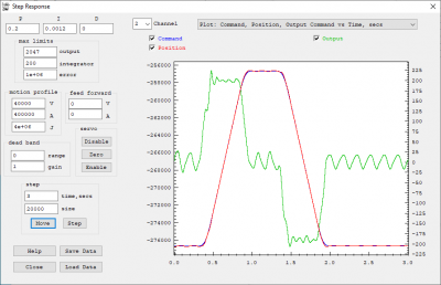

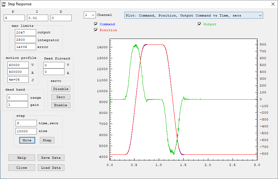

I have tuned my motors to the best of my current ability. Thanks for the direction to do that next. You were correct about the feeedback being reversed.
The first is the X axis, followed by the Z axis and then the Spindle. As you can see, the Spindle has quite a sizeable Following Error (if that's the correct term) and I cannot reduce it significantly using the Integral term as I was able to do quite successfully with both X and Z. In fact it becomes unstable before it has had any significant effect at all. X & Z behaved themselves pretty much like 'text book' cases.
Since it is the Spindle, perhaps it won't matter so much, although I would like to be able to do single point thread cutting with it. Maybe I can play around with the motor drives later and see what I can find there, but for now it will do. On with continuing to get my head around the C programming stuff tomorrow!

The one shown here. I realised what MaxOutput was about. That's how I was reducing the speed since it seemed to be ignoring the one above.What speed setting are you changing?

I'm monitoring this Bit shown here. If this is not what I should be looking at, then I will need help to find the correct one please. This one turns on and off when I operate the switch by hand.Are you sure you're monitoring the correct bit in the homing program?
