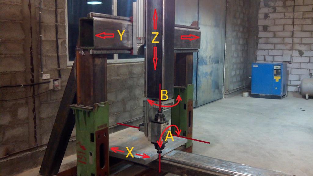

Q1 : are there any pictorial diagrams of 5 axis gimbal CB and 5 axis gimbal ab as I think the differenceiis the position of C0 either around Y or X ?
I think they are basically the same kinematics except one uses the AB to control the angles and the other uses CB to control the angles. I think CB is more appropriate as normally:
A is rotation about the X Axis
B is rotation about the Y Axis
C is rotation about the Z Axis
here is an image from the User who used Kinematics5AxisGimbalAB
And a Video
From this related Thread.
