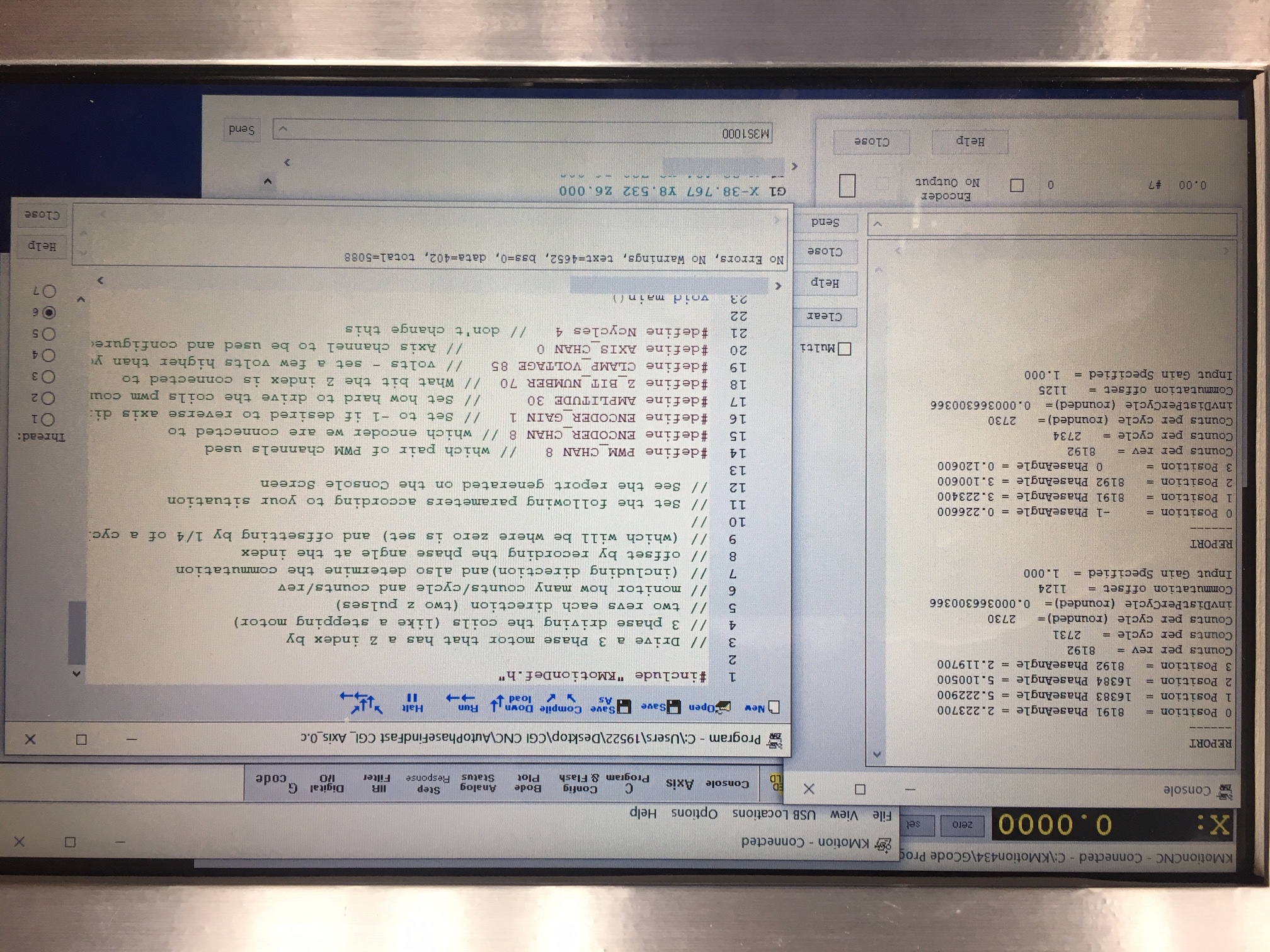

I've attached photos of the Console results as well as the HomeBrushless files.

I think the Auto Phase Find is not working correctly. It should rotate to find the index one direction twice then reverse. If you look at the Reports positions 1 and 2 are nearly the same. They should be one rev (probably 8192 counts) apart. After finding an index pulse there is an ignore period where enough motion is made to assume the previous index pulse goes away before looking for a new index pulse. It there is a lot of friction then there may not be enough motion to move off of the previous index pulse so it is incorrectly detected as a new index pulse. Try increasing the 'ignore' values to get it to work correctly.

Yes, I noticed the two middle values were the same as well. I thought that maybe the shaft was stopping just past the Z channel in one direction and then it sees the Z channel again coming the other way. Either way, the results are still useful and with a bit of logical tweaking I was able to get correct values. However, I was still not able to get the negative offset value to work so I am running with the swapped motor leads. Not a big deal, just the wire colors and the U,V,W signal names aren't in the same sequence as the other motor.
