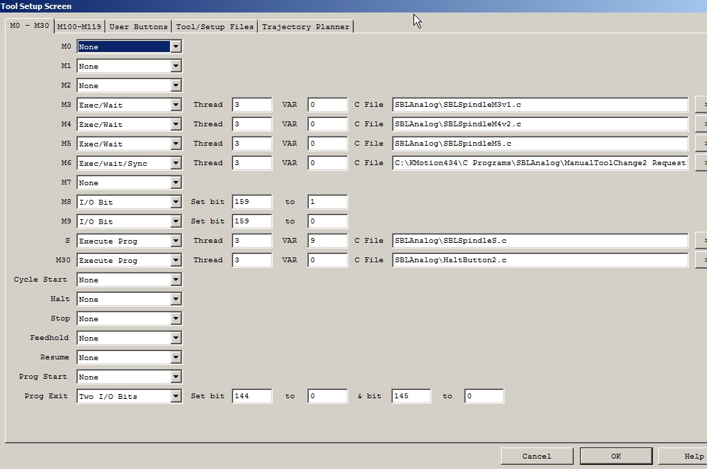

If you still cant get it to work properly, post all your M3,M4,M5,S Spindle Programs and the Tool Setup Screens (M0 - M30 and Trajectory Planner Pages).
Also Single step through the GCode and tell us which line is executed and what the Console shows.
