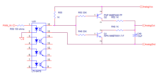

Here is the circuit.
As you can see it has 1K output resistance. I'm surprised the drive seems to have 1K input impedence to divide the voltage in half. You might try your 9V battery through a 1K to see if it has the same problem to prove this.

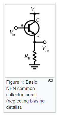

I made a basic follower circuit with a 2222a NPN transistor and a 4.7k resistor. Maybe I need some other components, but this worked. Here is the schematic I followed (image from wikipedia):
The circuit seems to work well. If it should have further components please advise.

The optocoupler limits the voltage to 35V. The transistors are rated for 0.3A but the 1K resistors limit the current to much less.
