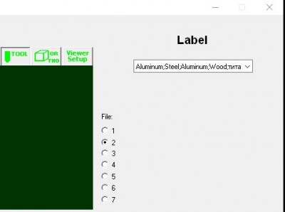

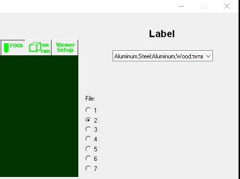

Hello Tom.
Finally i test this, in load the last version 435d, and it does not work as described.
I load the combo.scr to test it but the box looks like in the attached picture. Please advice.
Regards.
Re: Custom COMBOBOX
Post by TomKerekes » Wed Oct 21, 2020 5:06 am
Hi cnc_freak,
Here is a patch that should fix the issue in Version 4.35d.
