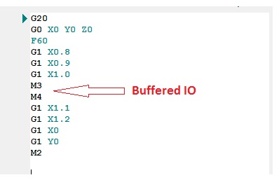

It’s possible to add MCodes within the GCode to switch the Laser on/off at precise positions without stopping the motion. See:
http://www.dynomotion.com/Help/KMotionC ... mmands.htm
Maybe that would work for you.

It seemed to me that the G1 command ended with a servo stop.
I'll try to use this approach.

G1 moves should not cause a stop unless there is a sharp angle (> Break Angle). That is how curved paths consisting of many short segments are used to cut at a continuous feedrate.
