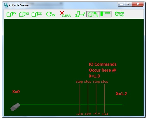

I mean that when using G-code for laser engraving, due to frequent stops when changing colors, the running time will increase.
Yes. This should look like a bitmap editor, with a contour highlighting feature. Kflop should work as a laser printer.
At black points, the laser turns on, turns off the white ones. I plan to add this feature to the laser cutter.

It’s possible to add MCodes within the GCode to switch the Laser on/off at precise positions without stopping the motion. See:
http://www.dynomotion.com/Help/KMotionC ... mmands.htm
Maybe that would work for you.
How many Engravers do you intend to build?

It seemed to me that the G1 command ended with a servo stop.
I'll try to use this approach.

G1 moves should not cause a stop unless there is a sharp angle (> Break Angle). That is how curved paths consisting of many short segments are used to cut at a continuous feedrate.
