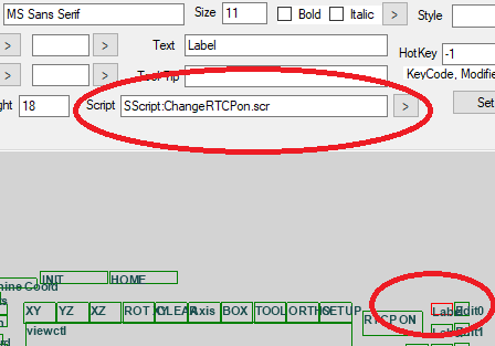

I can't see a reason why running a SubScript from a button Action would be any different from a C Program running a SubScript. I tried below and it seems to work for me. Maybe you could provide an example that shows a problem.
KMotionCNC already supports a means of including files via SubScripts. I've attached an example where RTCP1 "includes" RTCP2. However the Screen Editor doesn't support this for reading or writing. Does that work for you? I like your idea of writing back to the original files. We'll look into that.

Attached is a Screen Editor that should read Screen Script files with nested SubScripts. It also shows the hierarchy. But can't write them. I've attached an example with a main RTCP1T and 4 subscripts.

I was a bit confused by the RTCP2 file content. It included the base page content plus the additional content of the subscript. I've included modified files RTCP1_LJD.scr and RTCP2_LJD.scr that represent what more of what I'm trying to implement. Initially it didn't work. I think the problem I was having was caused by my trying to load the base page using the Screen Editor. Once I went into the GCodeConfigCNC.txt file and change the screen to load, it worked. I think the bottom line is that the base page can only be loaded directly by KnotionCNC (as you indicated). My files didn't use the include because I didn't realize it was available. So I still need to figure out why my button actions couldn't load subscripts with incompletely defined controls. But with the example you have given me (But30 & 31) and knowing to not try to load the base page with Screen Editor, I should be able to track it down. I'll confirm when I get my screens working or will be back with more questions :)
