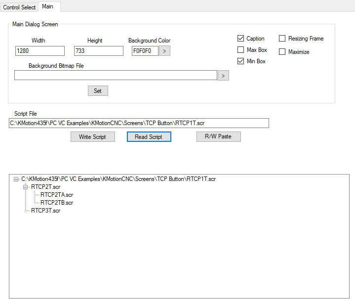

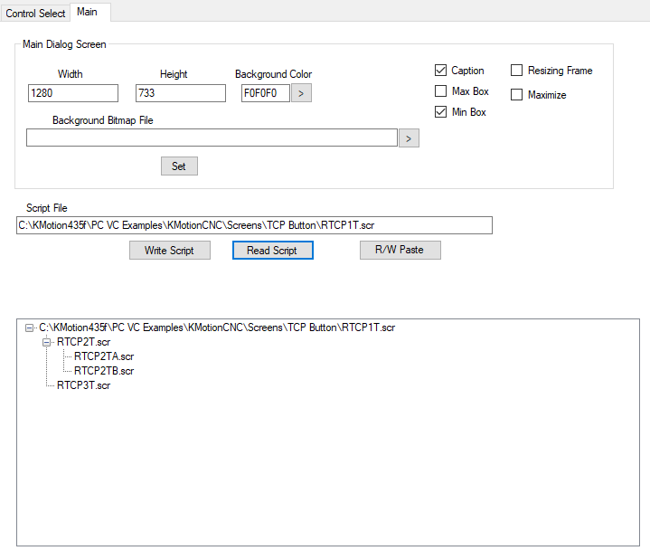

Attached is a Screen Editor that should read Screen Script files with nested SubScripts. It also shows the hierarchy. But can't write them. I've attached an example with a main RTCP1T and 4 subscripts.

The new Screen Editor works great, thank you! I like that it keeps the content in the order read in when it does a write out.
