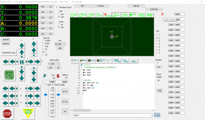

I would like to add a cycle counter to the KMotionCNC screen. Ideally it would have a zero reset button and a display to show cycles run since last reset.

You might add a DROLabel to your screen such as shown here in red.

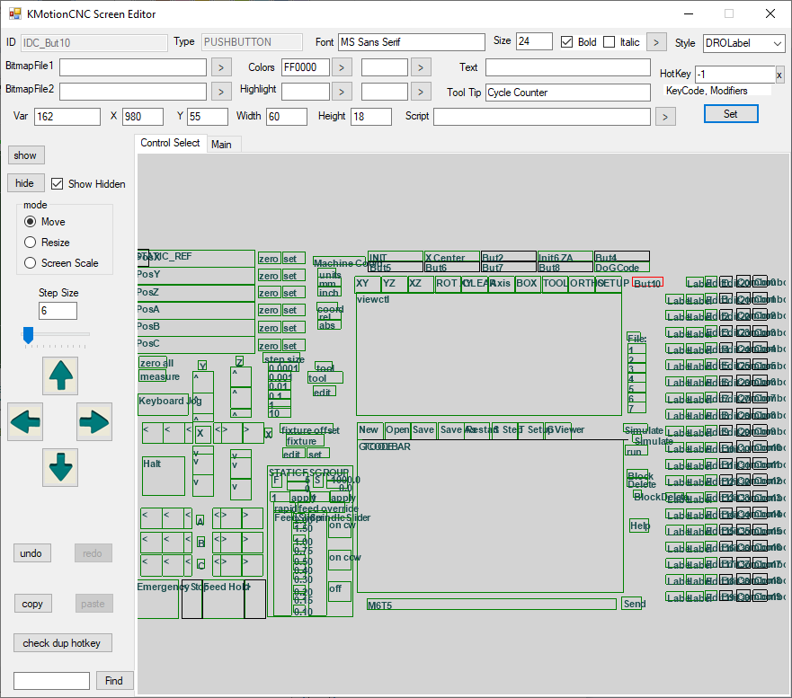

Configure it to monitor Var 162 for a string to display as shown here:
Now create a C Program to increment a persist Variable Counter and display it on the screen. We use Var 50 for the counter.

Then call the Count Program when you want it to increment. For example you might have M30 (end of Job do a count)
You might also add a User Button that executes the ClearCount.c Program to Clear the counter
