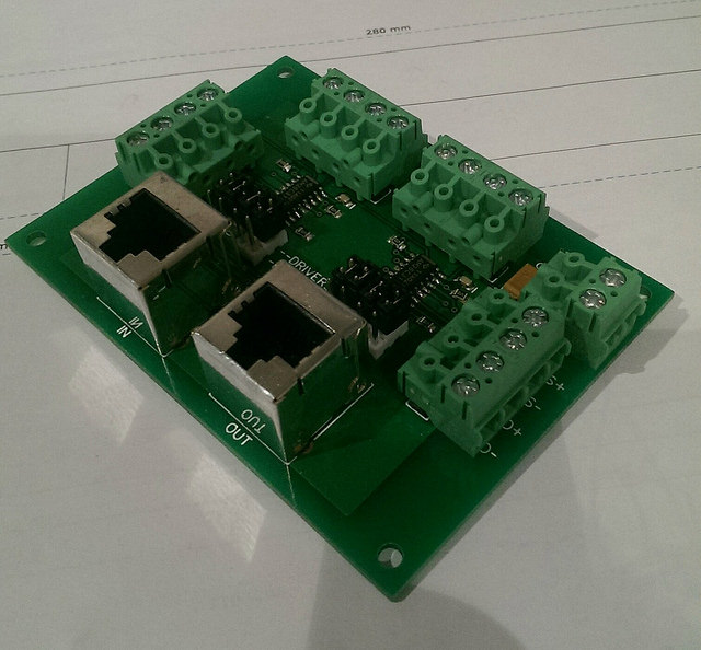

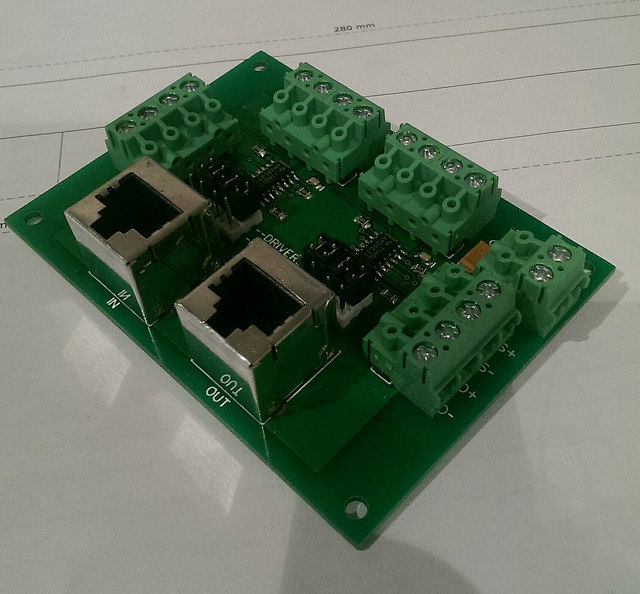

Regarding the differential outputs, if you're interested, I've got a batch of PCBs for outputting the JP5 step/dir outputs to differential outputs. They have two RJ connectors for input/output, with jumpers to select if signals are passed straight through from the input RJ to output RJ, or diverted to line driver chips, with the differential outputs going to the same pluggable connectors as other Dynomotion boards use.
I made them so I could select if Kanalog encoder inputs 4-7 are used, or the KFlop step/dir channels 4-7 were output to differential outputs.

Hi moray,
Do you have board diagram and component list for the board you shared ??

Hi Amit,
I do, however they're in DipTrace format, and I think you may need some of my custom libraries to view them. I would check, but I don't have DipTrace installed on this PC.
I also have the required output files to get the PCBs made at seeedstudio.

Hi Amit,
Diptrace files attached for the board.
I think you'll need some of my custom component libraries, but I'm not sure what ones, as it's been a while since I created this design.
