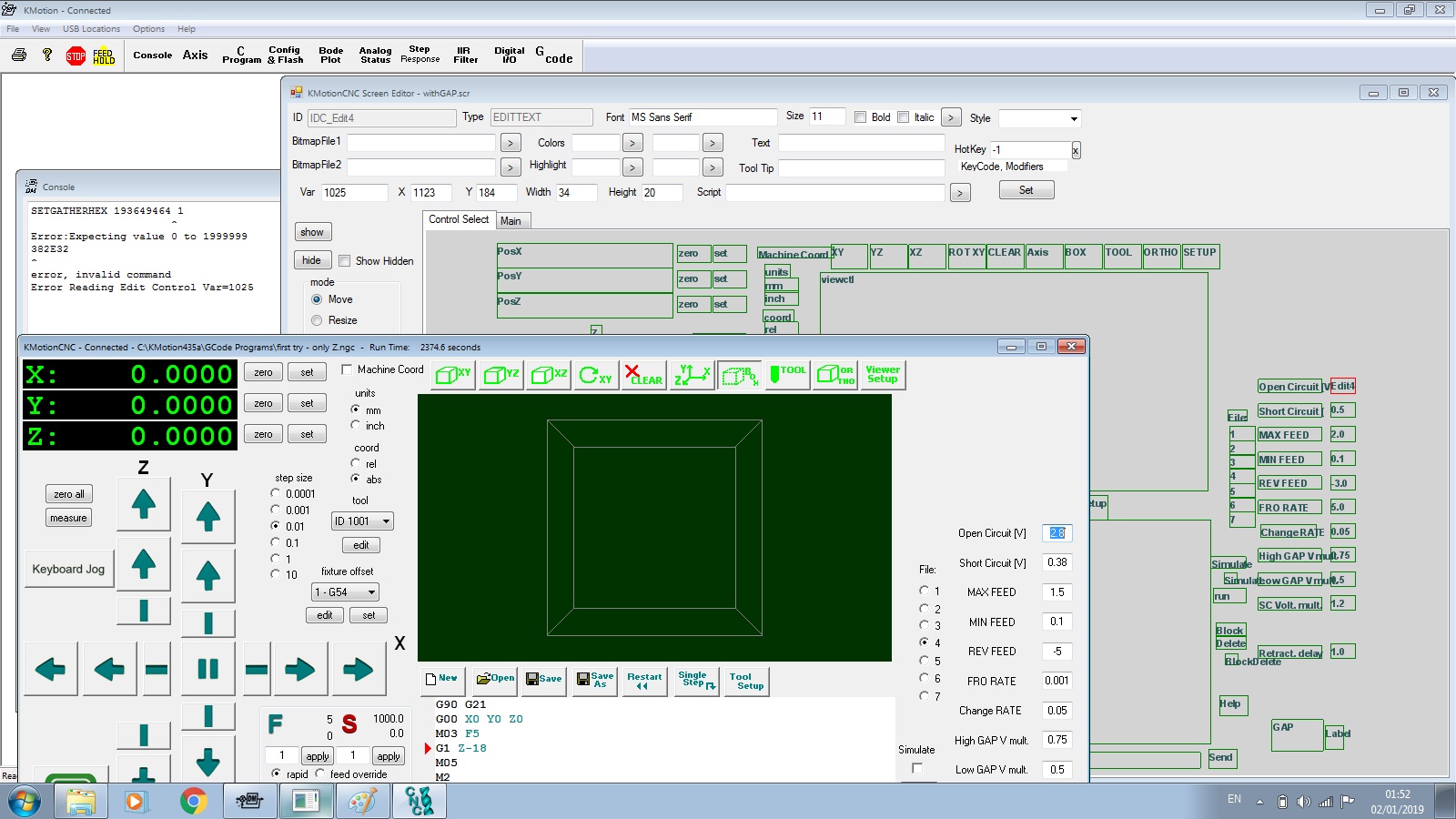

Now I have a little problem to transmitting values from the KmotionCNC screen to the code, I implement the example of add.c, but I'am getting an error. For example, The first variable I want to transmit are Open Circuit Voltage value, the control box is linked to variable 1025:
if (GetEditControlDouble(&OC, 1025, 1000))
	printf("Error Reading Edit Control Var=1025\n");
	return 0;
I put inside 2.8 (for example) but when I push INIT button I have an error (at the console) - Please see attached screenshot.
Re: EDM GAP control C code
Post by TomKerekes » Tue Jan 01, 2019 1:31 pm
Hi Gennady,
Wow very cool.
The Edit Controls and the DRO Labels communicate between KFLOP and the PC using one of the 200 KFLOP persist variables as a trigger word that have a range from 0 - 199. So try using a number like 160 instead of 1025.
