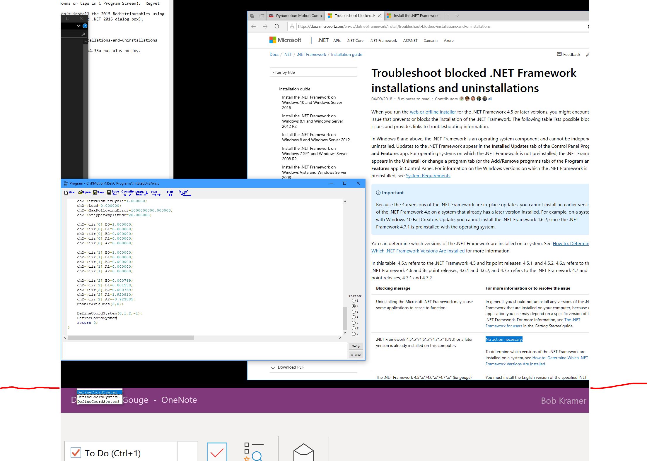

1) Tried renaming KMotion.exe (v4.35a), but got same results (no drop downs or tips in C Program Screen). Regret not trying that with v4.34 (prior to my next step).
2) Uninstalled the Microsoft Visual C++ 2017 Redistributables, but couldn't install the 2015 Redistributables using your file (NDP462-KB3151800-x86-x64-AllOS-ENU.exe). Win10 reports (via a Microsoft .NET 2015 dialog box);
"Your installation will not occur. See below for reasons why.
.NET Framework 4.6.2 or a later update is already installed on this computer."
Not much help from Uncle Bill; https://docs.microsoft.com/en-us/dotnet ... tallations (TL;DR "No action necessary.)
3) Removed every app possible from laptop (I was overdue so a good thing). Reboot, reinstall v4.35a (which successfully installed MS Visual C++ 2015 Redistributable (x64) and (x86)), but alas still no drop down list or function tip visible in C Program Screen.
4) Then I noticed the drop down was there (perhaps it was there all along), but it was on a different monitor. In the attached snip (which is across two monitors, vertically stacked - red line is monitor boundary), you can see it superimposed on the Title bar of MS OneNote (which was full screen on monitor 1). When your C Program Screen was moved to the primary monitor (#1 below), all is well.
Perhaps just an edge case (or something unique to my environment), but FYI.
Seems like the Scintilla project has seen this before;
#744 Autocomplete list only displays on primary monitor. https://sourceforge.net/p/scintilla/bugs/744/
#745 Autocomplete list only displays on primary monitor. https://sourceforge.net/p/scintilla/bugs/745/
#1920 GTK: incorrect popup placement on secondary monitors. https://sourceforge.net/p/scintilla/bugs/1920/
