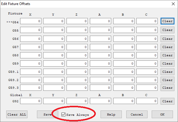

Hi
Which command can I use to save the parameters stored in the Work/Fixture offset table (G54, G55, etc).

Hi EondeK,
There isn't a command to explicitly save the offsets. But there is a "Save Always" option on the Edit Fixture Dialog that will automatically save the offsets to disk no matter how they are changed. Does this work for you?

Hi Tom
I checked and on the version I have, the Save Always tick box is not there. How do I add that?

Post by dynomotion » Wed May 30, 2018 3:55 pm
The "Save Always" option was added with version 3.34f. You can download the latest test release here:
http://www.dynomotion.com/wiki/index.ph ... are_Topics
