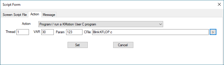

You can use the Screen Editor's Script Dialog to help form the screen script for an Action. Selecting different Action Types will show the related parameters.
Clicking Set will create the Script:
Action:4;1;30;123;0;0;BlinkKFLOP.c
