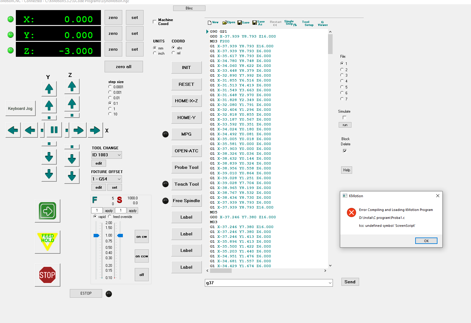

Post by Tarasevih » Wed Mar 20, 2024 5:52 am
Hi Tom.
I used your example as is
extern volatile int ThreadActive;  // one bit for each thread
	if (ThreadActive & (1 << 4)) return; // if Thread 4 is executing exit
	if (ScreenScript("Action:4;4;0;0;0;0;BlinkKFLOP46.c"))
But the compiler asks to assign a ScreenScript variable.
Taras.
Re: C program streams
Post by TomKerekes » Wed Mar 20, 2024 5:13 pm
Hi Taras,
The function ScreenScript should be defined in KflopToKMotionCNCFunctions.h. Is it?
