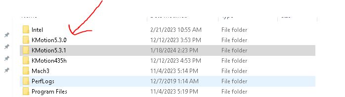

Re: idk why lathe changes
Nothing should change without a reason, but to eliminate the possibility of something pointing to an old install, rename the directories.
I usually put an 'x' at the end, so that way if anything does happen to still be using an old install, it will break the link and generate an error, and renaming avoids deleting anything that you might still need.

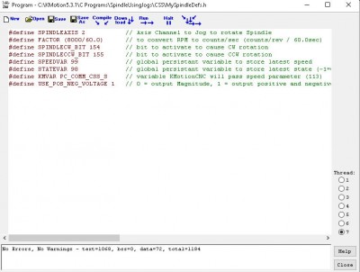

so only CCW jog, spindle jog, off jog, settings and spindle def controls the actual spindle right????
right now CW jog does not even move
where does the myspindledefs file supposed to live?
the spindle shows the DAC at full power and yet the motor is winding up 100x slower than it should
it completely over shoots both ways even with full DAC command
i am about to put voltage gauges on DAC outputs and servo power supplies

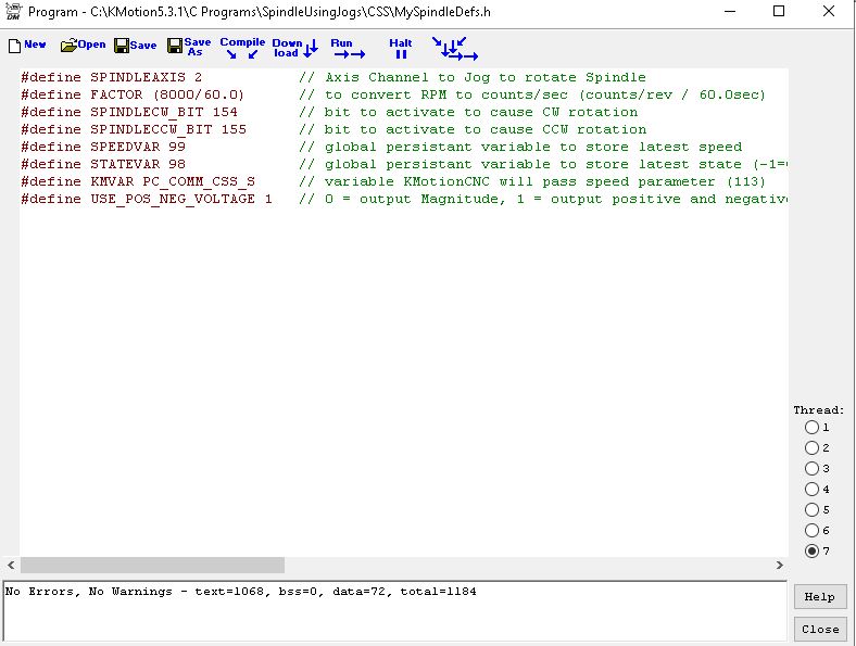

Also check the CW and CCW bits to the Spindle. Are they set properly? How is the Spindle supposed to be controlled? Your MySpindleDefs.h has UsePosNegVoltage set so I'm guessing it uses +/-10 to control the direction. What type of control bits does it have?
Again rather than jumping all around I'd focus on one thing at a time.
It isn't clear what you mean by this. How can the Spindle show anything? Maybe you mean the DAC is at 2047? If so the DAC voltage should be -10V. Measure with a Voltmeter. What is it?the spindle shows the DAC at full power
It isn't clear what you mean by this. Is its velocity low? Or high but gradually accelerating?the motor is winding up 100x slower than it should
Normally yes. But some of your code seems to indicate you are also using the Spindle as an A Axis. Are you?so only CCW jog, spindle jog, off jog, settings and spindle def controls the actual spindle right????
In the same folder as the Spindle Programs.where does the myspindledefs file supposed to live?

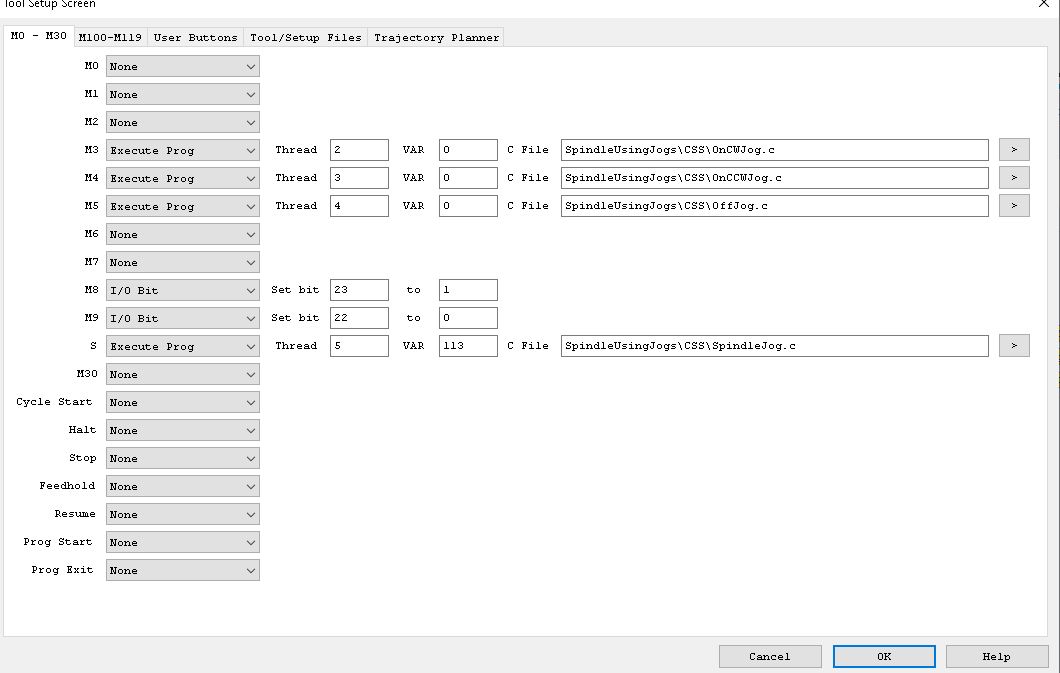

if i use the
SpindleUsingJogs\SpindleOnCWJogV2.c
SpindleUsingJogs\SpindleOnCCWJogV2.c
SpindleUsingJogs\SpindleOffJogV2.c
for spindle control, what do i use for the speed?
- Capture.JPG (10.7 KiB) Viewed 32223 times
- Posts: 2931
It would be SpindleMillJogV2.c but those are obsolete. Please use the ones in \SpindleUsingJogs\CSS\
