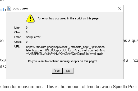

on a side note, i get this error when i bring up the help menus

Regarding the help Version 5.3.0 should not do this.

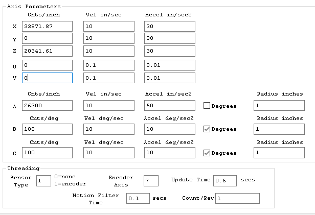

the X axis screw of 0.23622 Inches pitch and 2000 count then the Z screw of 0.3937 Inches pitch and 2000 count
