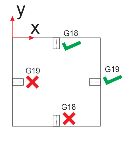

I have finally tested this commands to change the plane.
It worked for drilling operation when the the hole pointed to the negative direction from the axis.
But, when in the opposite direction the KMotion pops a G code error stating that the parameter R from G81 is smaller than the x or y in the plane selected.
The following sketch shows a 2D square with horizontal holes in X and Y. It represents in which directions the cycles from G81 worked or not:
You can see a way to solve this problem?
Sincerely,
Guilherme

Hi Guilherme,
Unfortunately the Canned cycles are expecting to only drill "down" not up.
I suppose you could reconfigure (reverse) the axes for those cases. But offsets might then get complicated.
You might use a subroutine for the cycle as shown below:
(G90 G81 G98 X1 Y0 Z-5 R-10)
#1 = 1 (X Drill location)
#2 = 0 (Y Drill location)
#3 = -5 (Z Drill Depth)
#4 = -10 (R Retract height)
M98 P81 F100
M98 P81 #1=2 #2=2 (Drill at 2,2)
M98 P81 #1=3 #2=1 (Drill at 3,2)
M30
O81 (Canned drill cycle subroutine)
G0 Z#4 (Goto retract height)
G0 X#1 Y#2 (Goto Drill location)
G1 Z#3 (Drill)
G0 Z#4 (retract)
M99
