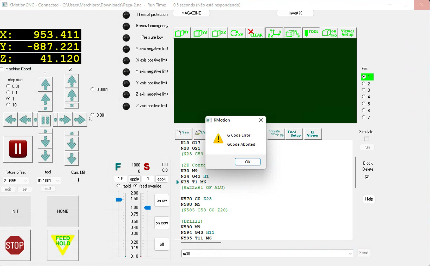

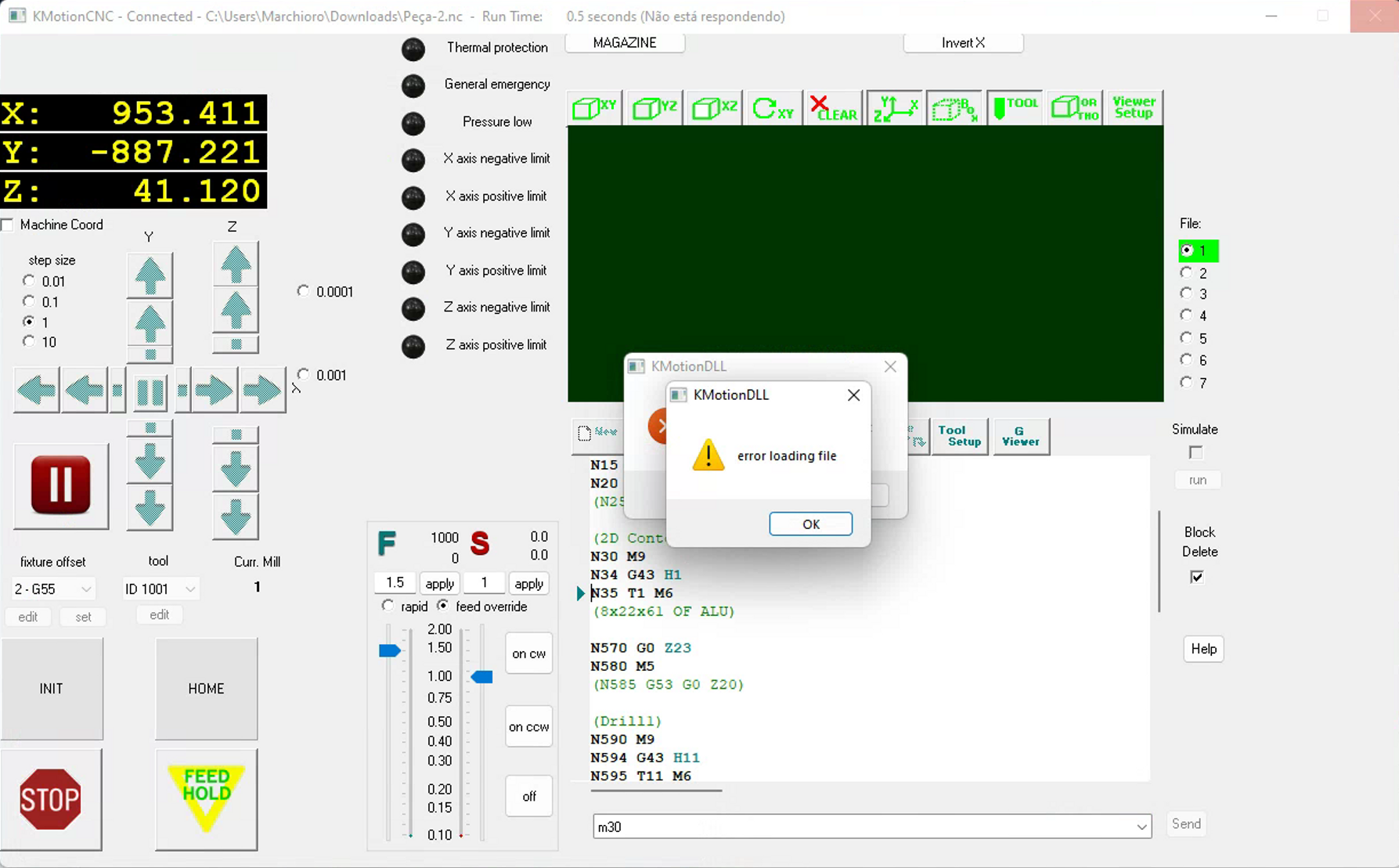

Sometimes when a G code program call an M6 command I get the following error that says "error loading file". By clicking Ok another message box appears stating that there is an error when compiling the M6 c program. And then a message saying that G code was aborted. To re-establish the system it is required to reset the board power and re-open KMotionCNC
I've checked KMotion and there is no output in the console, just a message box stating "Read failed - Auto disconnect".
It is not clear for me how can a c program not compile sometimes. I thought that this was not even possible. Have you experienced something like this?

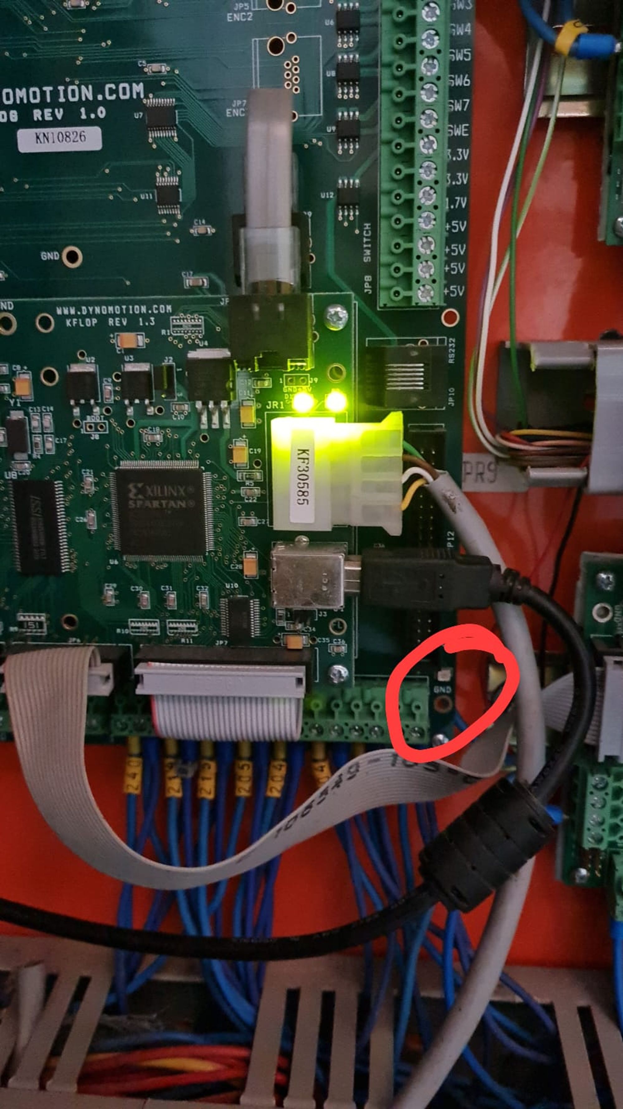

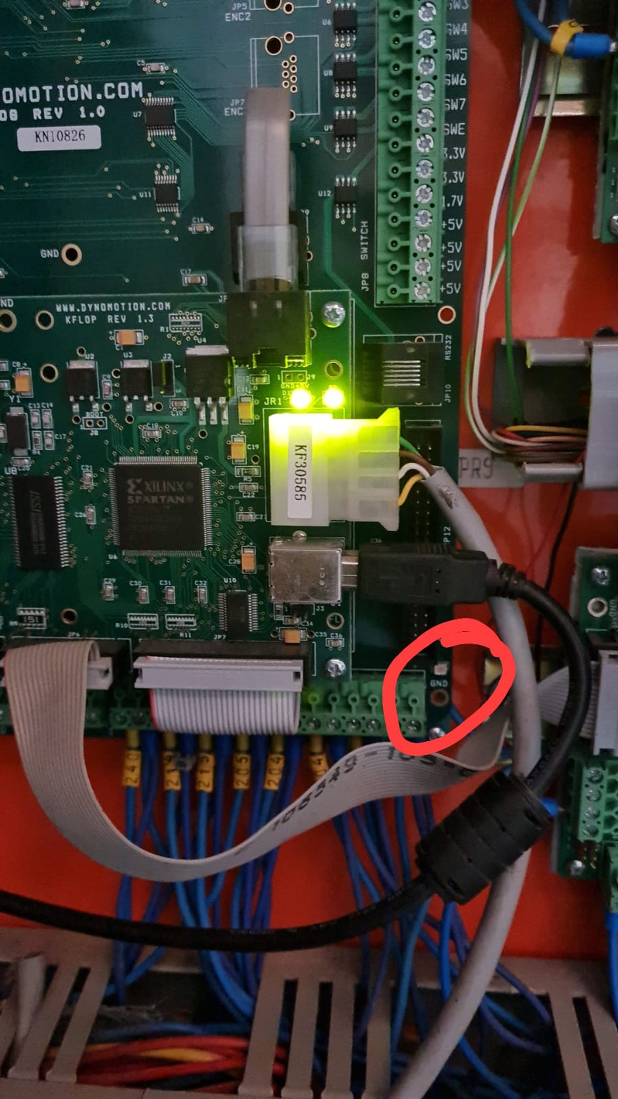

I checked the KFLOP/KANALOG boards and realize that when this situation happens the led pointed below becomes off.

- Posts: 2901
Re: Nondeterministic "error loading file"
Hi Guilherme,
What is printed on the KMotion Console Screen when the failure occurs?
Has KFLOP been reset?
How is KFLOP/Kanalog powered?
I don't think the problem is with compiling. Rather the problem is loading the program into KFLOP because of being disconnected or unresponsive.It is not clear for me how can a c program not compile sometimes. I thought that this was not even possible.
The IO on KFLOP JP7 is used to communicate with Kanalog. Basically IO 0-15. If a User modifies this IO the communication to Kanalog will fail and Kanalog will become disabled.I am not sure I understand what do you mean by a "program that modifies the IO used to communicate with Kanalog".
I can't see anything specifically wrong.Here is my program that runs when an M6 is called:
gui_marchioro
- Posts: 61
Hello Tom,
Good to know. I have reviewed the code just to make sure, but I am not using any of those.The IO on KFLOP JP7 is used to communicate with Kanalog. Basically IO 0-15. If a User modifies this IO the communication to Kanalog will fail and Kanalog will become disabled.
Right, me neither.I can't see anything specifically wrong.
As I have said in my first post nothing is printed in the console, just the message box about disconnection.What is printed on the KMotion Console Screen when the failure occurs?
The board does not reset by itself, but I need to manually do this to make the system work again. From my first post:Has KFLOP been reset?
