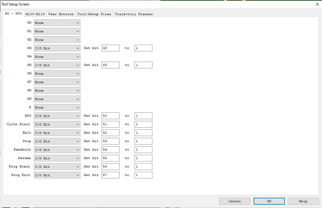

I try it but did not work as expected. I assign a toglle button on the screen, with a var 1026 to exec/wait my c program. When i press this button then the program is executed. Also i assign to the M3 function on the tool setup screen on the KmotionCNC a variable 48. This 48 variable is checked in my endless main loop and when goes true, then a function is called, which makes the 1026 variable true, "SetBit(1026)". When a M3 is executed in a Gcode program, the only think happens is the variable 1026 goes true, but the c program assosiated, with this variable/button does not execute.

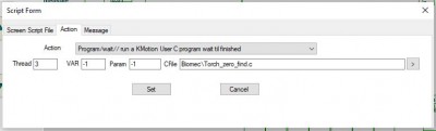

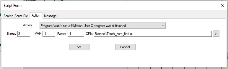

If you're using screen script then it would be simpler for KFLOP to command the Action to run the program directly. For example:
//For example "WinMsg:Keyboard;;KeyPress;120" to press F9
//For example "WinMsg:DlgName; IDC_SpindleOnCW; BM_CLICK;" to click the Spindle on cw button
//For example "Action : 5; 3; 0; 0; 0; 0; SpindleUsingJogs\CSS\OnCWJog.c" to execute/wait the seec prog in Thread 3 Var 0
if (ScreenScript("Action : 5; 3; -1; 0; 0; 0; print.c"))

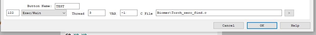

I try this "ScreenScript("WinMsg:Keyboard;;KeyPress;122");" in the endless loop, in the function that handles M3. I also assign to the user button 9 the action Exec/Wait to c function Torch_zero_find.c, with key = 122 = "F11", via Tool setup on KmotionCNC.
When a M3 is executed on a Gcode programm, the Torch_zero_find.c is executed, but the the Gcode programm does not wait until the Torch_zero_find.c finishes.

You might add a wait in the M3 C Program to wait until the Torch_zero_find.c is finished. One way would be to set a Virtual Bit before the KeyPress. Then have Torch_zero_find.c clear the bit when finished. And of course have the M3 C Program wait until the bit is cleared.

But this is supposed to do the "Exec/wait" action , to wait until the Torch_zero_find.c finishes.
In the main loop the M3 bit (48) is checked:
//= M 3 =
if(ReadBit(M3)){
DoM3();
And this is the start of the DoM3 function:
// - M 3 Function -
void DoM3(void){
//- P L A S M A O P E R A T I O N -
if(ReadBit(PLASMA) && !ReadBit(T_SELECT1) && !ReadBit(T_SELECT2) ){
//= M 3 =
if(ReadBit(M3)){
DoM3();
// - M 3 Function -
void DoM3(void){
