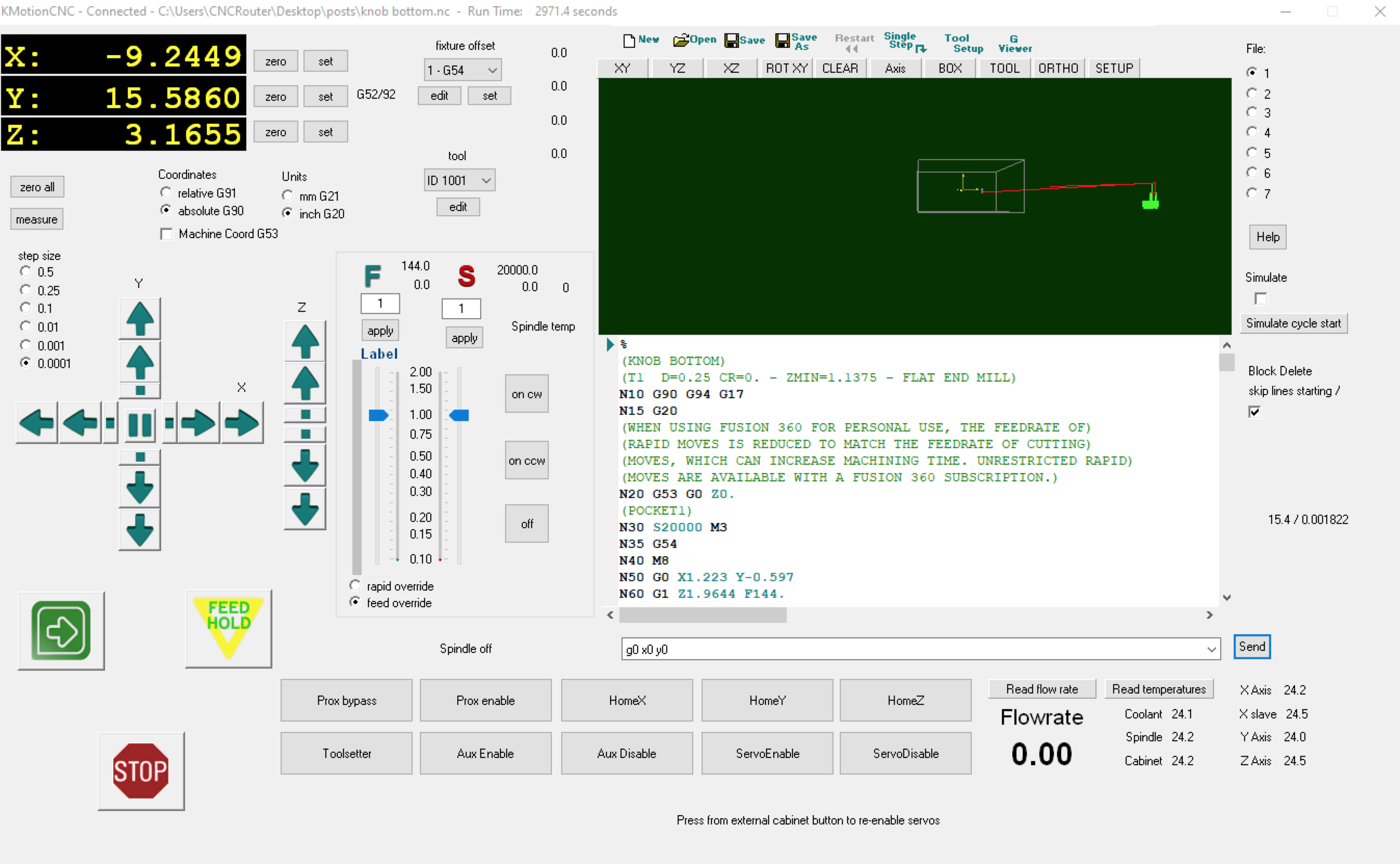

I recently tried to add some extra functionality to KmotionCNC, mostly around reporting some additional DROlabels on the screen to report what is happening in the KFLOP, and implementing a toolsetter program that is activated by setting a bit through a user button. Mostly it works fine, but once out of every 10 tries or so it will not report the text in a MsgBoxNoWait as it should, instead producing either an empty OK box or an OK box with about 20 garbage characters in it (empty one attached). The Z axis stays sitting on the toolsetter in this case, and pressing OK does not cause it to move upward like the following "MoveRel(ZAXIS,18514.67366); // move up from knife to 4.0 inches off table (underside of toolsetter)" command should do, and the subsequent dialog boxes are not presented.
Another behavior is that periodically KmotionCNC will also hang, unresponsive to the mouse/keyboard, but still updating the DRO fields from the KFLOP as normal (including a coolant flowmeter that varies in use, giving a source of live data), until I unplug and replug the USB cable, at which time it recovers and works like normal. Not sure if that is related? This one happens infrequently enough that I haven't been able to deduce a common event for it happening.
I have been defining the variables and memory like below, my understanding is that the VAR field is the link from KFLOP to KmotionCNC's buttons and the MEM is the address in the KFLOP memory to be sent to that button (correct?):

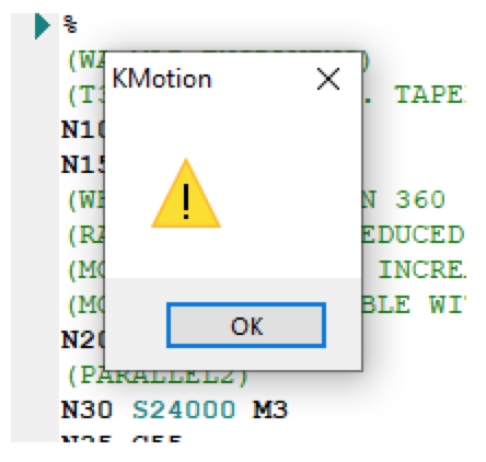

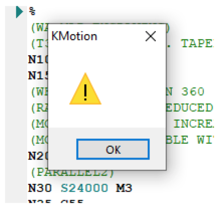

			} else if(!ReadBit(TOOLSET_KNIFE)) {
				sprintf(text, "Toolsetting Complete. Position %f\nSet to 4.000 inches on DRO.\n", chan[ZAXIS].Position);
				// 20807.68 counts/inches (79mm)
				// trigger is 3.1102" above table 0" above table
				MsgBoxNoWait(text,MB_OK);

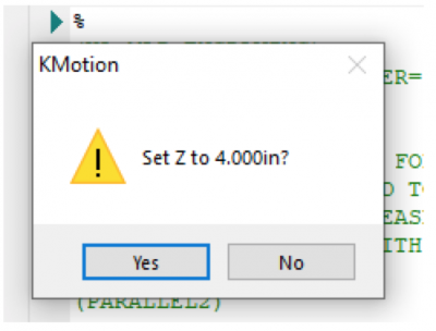

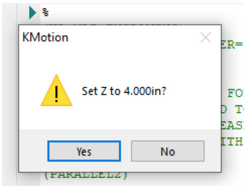

				Answer = MsgBox("Set Z to 4.000in?\n",MB_YESNO|MB_ICONEXCLAMATION);
				if (Answer == IDYES) {
					printf("Answer is Yes, set Z to 4.000in\n");
					DROLabel(MESSAGEMEM,MESSAGEVAR,"Answer is Yes, set Z to 4.000in\n"); //KFLOP memory location, KMotionCNC variable (?), value
					DoPCFloat(PC_COMM_SET_Z, 4.0);

The code is somewhat complicated and much of it wasn't posted, but two things come to mind:
#1 text is allocated on the Thread's stack and is uninitialized so its contents can be random each time ServiceToolsetter() is entered. Actually this is somewhat large to be placed on the stack as each Thread's stack is only 2KBytes. Adding "static" in the declaration will make it global where there is 64KBytes of thread memory and also allow it to persist from one call to the next.
char text[1000];
text is sometimes sent to a message box toward the end of the routine. It's not clear that its contents are always set before it is used on every pass through the routine when it is used.
#2 - Its not clear why you are using MsgBoxNoWait. In general the way most commands to KMotionCNC work is:
(1) - KFLOP assumes no command is currently in progress.
(2) - KFLOP sets any data and parameters needed for the command
(3) - KFLOP sets the command code
(4) - KFLOP waits for the command to be completed as either successful (0) or failure (negative value) from KMotionCNC
(5) - KFLOP reads any data that the command might have returned
MsgBoxNoWait is a special case where step 4 is skipped in order to return immediately and never wait. However it is the caller's responsibility to verify the command eventually completed before issuing any other commands. If a new command is issued before the previous command is completed then data and/or commands maybe overwritten, lost, or corrupted.
