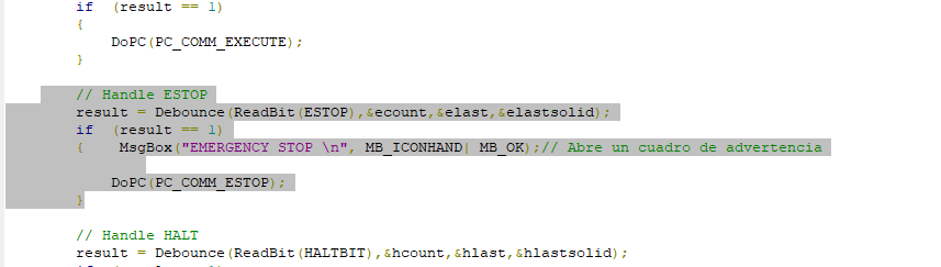

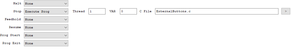

I am trying to add an E-stop (emergency) button, as indicated in this document.
Do I assign it to the M code (Stop) as shown in the figure below. Is that correct?
Another question, when I press the Estop button, it executes the C code and disables the axes, if for some reason the communication between the PC and Kflop were to be lost, this method would not work.
Is there a way to make the E-stop button work in Hardware?
Thank you very much, regards.
No. Add it at he end of your Init C Program.
Yes. Add C Code to do whatever you want EStop to do. ie disable axes or turn off contactor relay.

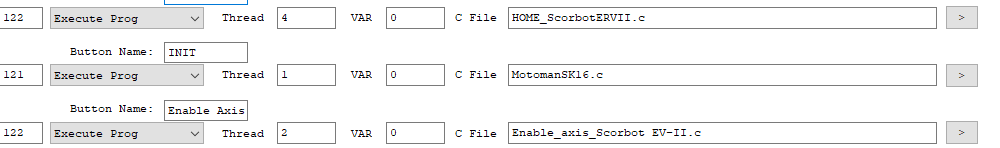

It already loads the code to my INIT program. I hope this is the correct way
If I understood correctly, would I have to add code in c to activate or deactivate relays in this part of the code?
MotomanSK16.c
(10.33 KiB) Downloaded 313 times
Re: External Button Set-Up
Post by TomKerekes » Mon Aug 07, 2023 9:14 pm
Yes within the 'if' condition.
