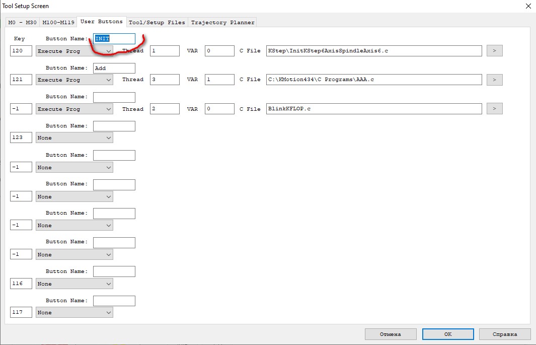

Re: Button name
Thanks Tom for the quick response. Can I do it from C program ?
I want to turn on and off RTCP one button and so that the name of this button changes RTCP_on and RTCP_off.
So I will know what mode the machine is in now.
Regards, Taras!

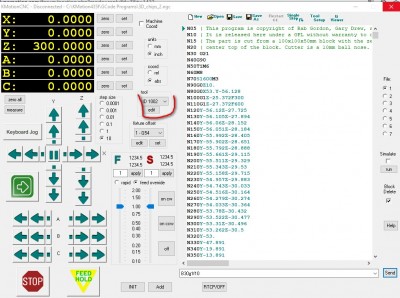

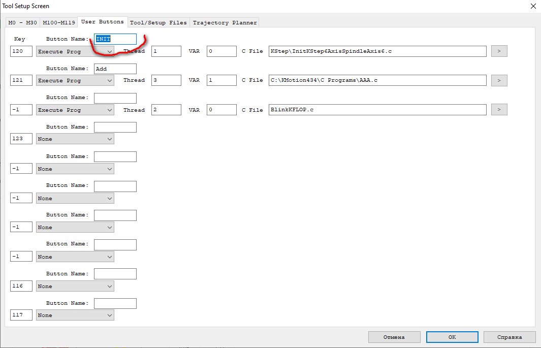

Re: Button name
Hi Tom. Maybe you're right. See screenshot. Is there access to this component from a C program?
Regards, Taras!
Regards, Taras!
- Posts: 2901
Re: Button name
Hi Taras,
Those are buttons. Why not use a Label using the KMotionCNC Screen Editor?
Re: Button name

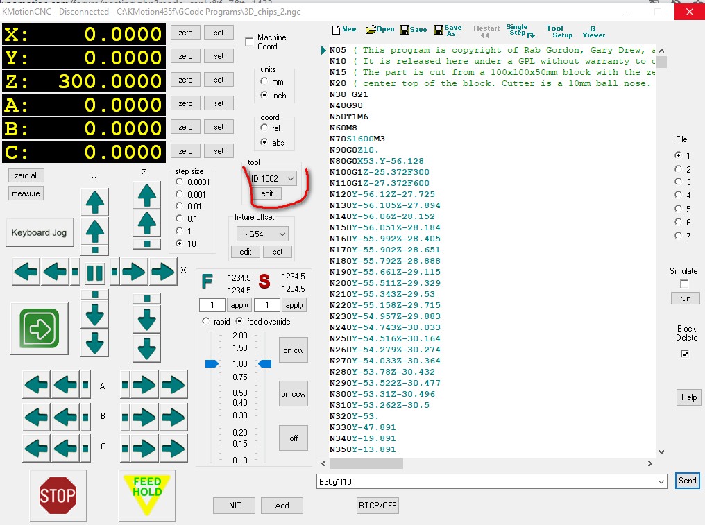

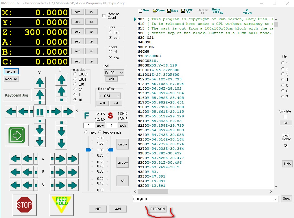

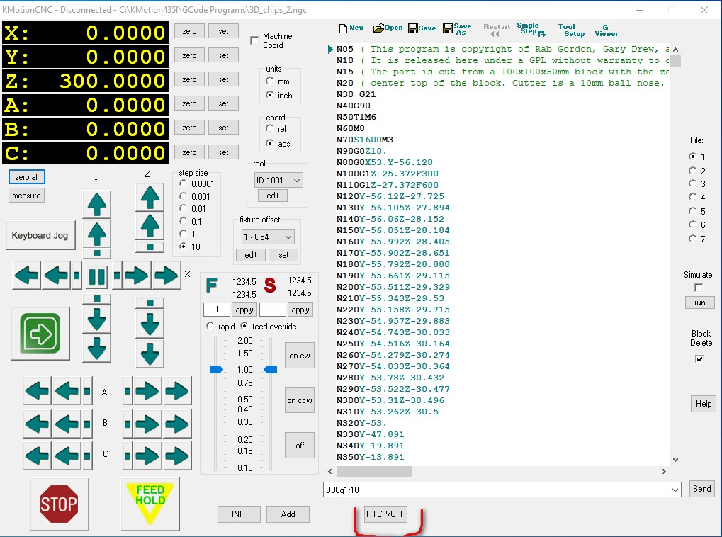

Hi Tom.You did not understand me. I need to change the text on a button to hot. During work KMotionCNC.
I want to turn on and off the RTCP with one button and also so that the name of the button changes as in the pictures below.
Regards, Taras!
Regards, Taras!

Re: Button name
Hi Tom. When changing the tool, it can be indicated as in the screenshot. When RTCP is turned on, take the tool number from the active one.
Sorry for my English.
Regards, Taras
