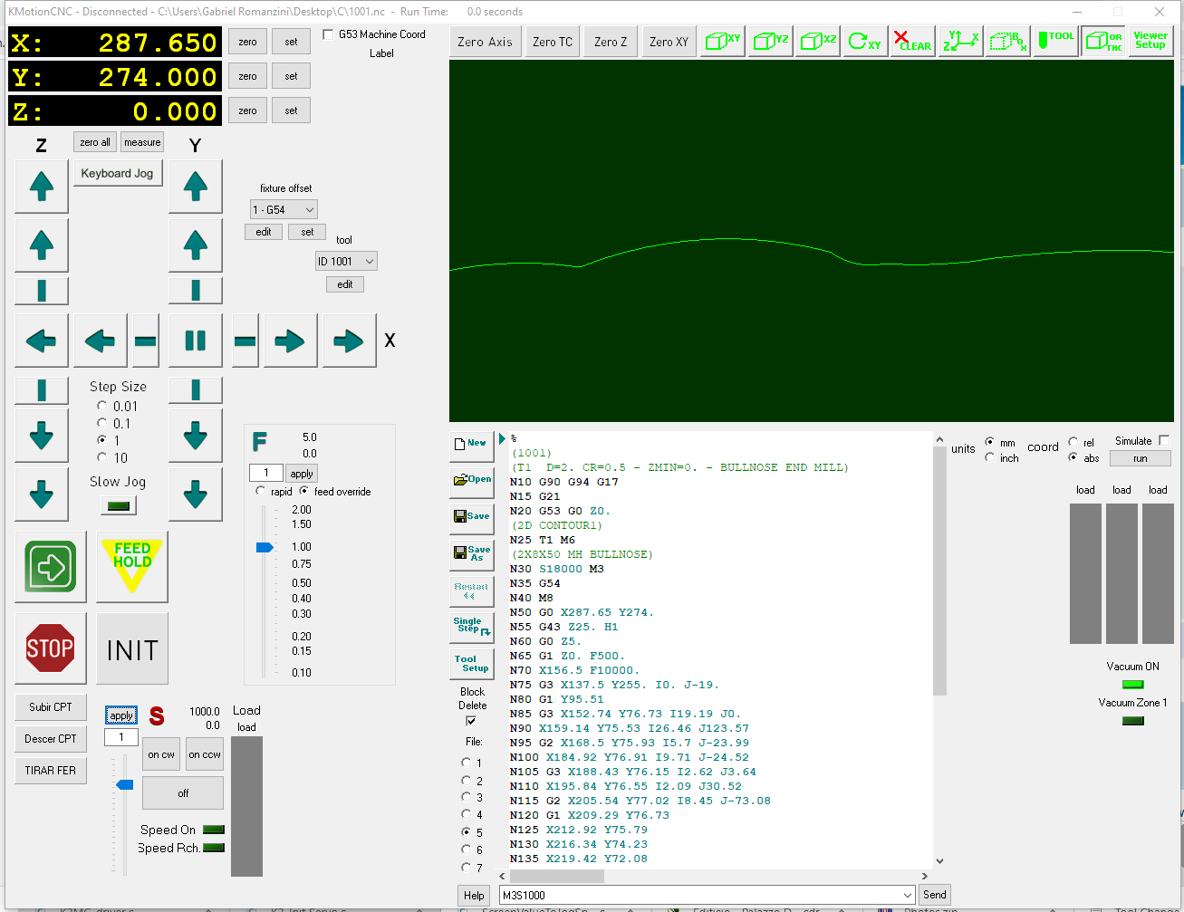

Hi Tom!
Been some time since we last talked. How are you doing ?
I'm getting some progress with my machine and the retrofit, the rotary tool changer is almost 100% configurated.
Right now I started to clean the screen and develop the way it suits better for me.
The ADC's works great and I managed to get Spindle Load and Axis load also, but i'm stuck with a problem.
I want to use buttons to control feedrate override, similar to mach3, +10% -10%.
I could do a C program to control the feed based on last pressed button, that would work.
If FR is at 100% and I press -10%, it goes to 90%, If I change the slider, it would go to a random value (ex 110%) and if I press -10% button again it would go to 80%.
Is there a way to read FRO before use the -10% button so if it was at 110% it would go to 100%?
I found PC_COMM_SET_FRO, but not the "get" one.
Attached a pic of the current screen (under development)
- Posts: 2901
Re: ADC Screen
Hi Gabrriel,
You can use:
DoPCFloat(PC_COMM_SET_FRO_INC,1.1f);
to increase the FRO by 10%
The variable CS0_LastFRO is the last FRO commanded.
You can use:
