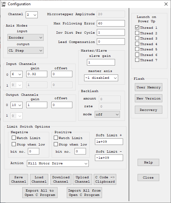

I have selected the power on boot option for Thread 1 and flashed to user memory.

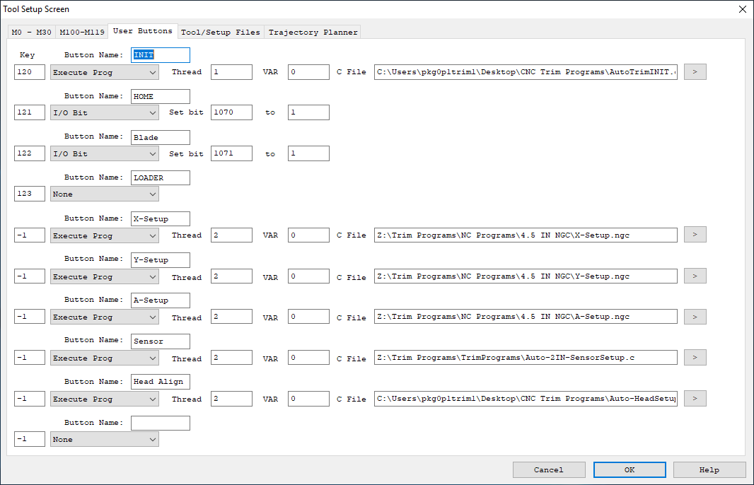

If I press the Init button on the KmotionCNC screen, it works like a champ.

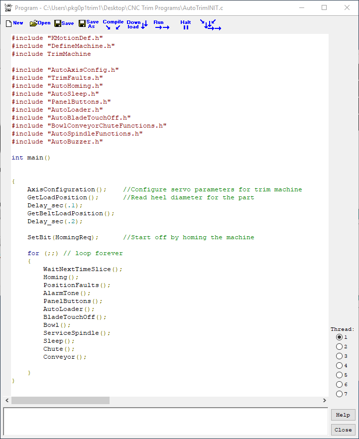

I am attaching images of the Init program and all of the config screens.
Init program

Could one of those routines be waiting for something from the PC?
You would need to post the actual code and the included files not a screen shot for us to help.
The steps you are performing to Flash seem correct, but you might Flash BlinkKFLOP.c as a test.
