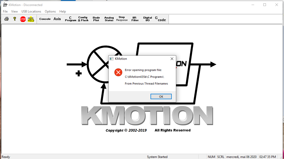

Hi, I open kMotion on my desktop. I push the "C Program" tab and I have an error: Error opening program file: C:\KMotion435b\C Programs\ From previous thread filenames. What can I do? I don't remember the last filename.

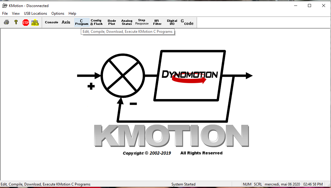

1) I open kmotion
2) I push on the tab "C Program"
3) If it's the first time, an error appair: Error opening program file: C:\KMotion435b\C Programs\ From previous thread filenames
4) Nothing open and I can't view any c program.
5) if I retry to push the tab "C Program", nothing append

Hi 4minnovations,

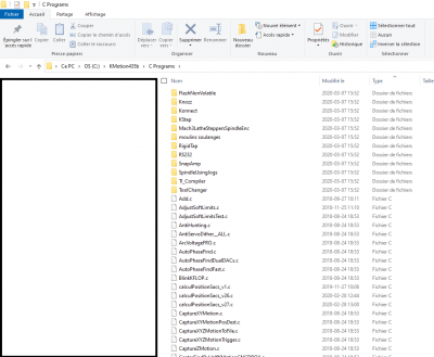

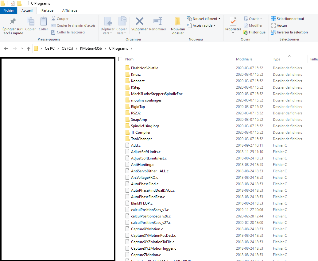

The error is because the last filename is blank. You can ignore that error. Does the C Programs Screen open after clicking ok to the error? Its up to you to know what C Programs were created for your system. You might search by date to see which .c files were modified most recently.

Re: C Program don't want to open
this is the problem, the c program tab with the seven thread didn't open after ok in the error.
