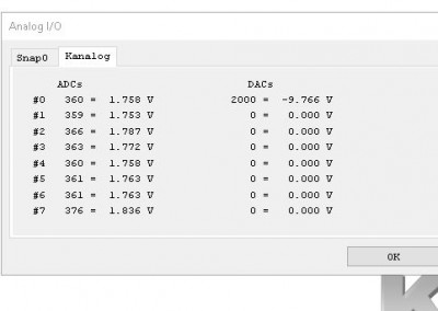

i notice when the X axis tries to run off ( i smack the Estop) and the DAC is at full output. this is with me jogging it only about -226 = 1.104 V
maybe this is the servo trying to catch up to position?
the axis can go nice and slow with jogging though......

- Posts: 2901
Re: simple 2 axis lathe initial lathe set up
If the servo is working (negative feedback to hold position) and you reverse the input gain then you will have positive feedback (runaway) instead of negative feedback. So you also need to also reverse the output gain to maintain negative feedback.my X axis runs away some and i think it is the encoder (mechanical related?)

If the Estop just removes motor power then KFLOP will ramp to full output trying to correct any error without any result. If you set small Max Following Error then whenever the servo can't correct the error then the axis will fault with a following error, the axis will disable, and the DAC will go to 0. So in this case the axis wont run away in the first place.i notice when the X axis tries to run off ( i smack the Estop) and the DAC is at full output. this is with me jogging it only about -226 = 1.104 V

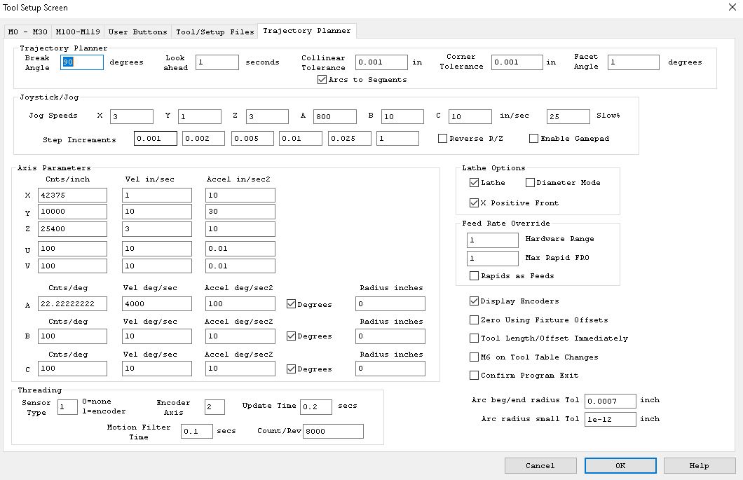

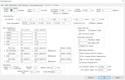

hey, if i have my step settings at 1.00 and the A axis on degrees. shouldn't it step a single degree at a time?
it seems to step kinda odd in that it is random steps about .600-.800 in the A axis
- Posts: 2901
See Axis Homing and Indexingis there any way to test the Z pulse on the spindle?
Yes it should. Observe the KMotion | Axis Screen. Does the Command and Position change by 22.2222222 counts?if i have my step settings at 1.00 and the A axis on degrees. shouldn't it step a single degree at a time?
