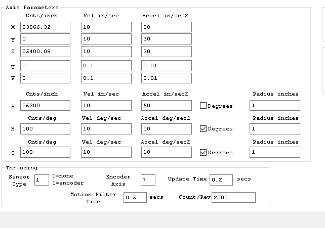

i got my Z screw all installed and got some encoder count from chatbot
i asked it by count and screw pitch x quadrature
2500 count (encoder)= 0.393701"(screw pitch) , 1" =?
6350.02
6350.02 x 4=
25400.08
is the .08 on the end good or bad?
dial indicator showed accurate over .500" sweep
ill get the 6mm screw info from chatbot too
Posts: 2901
Re: simple 2 axis lathe initial lathe set up
Post by TomKerekes » Thu Nov 16, 2023 4:13 pm
I think it should be 10mm/2.54 * 2500 *4 = 25400
However you might want to adjust the number for your actual machine.

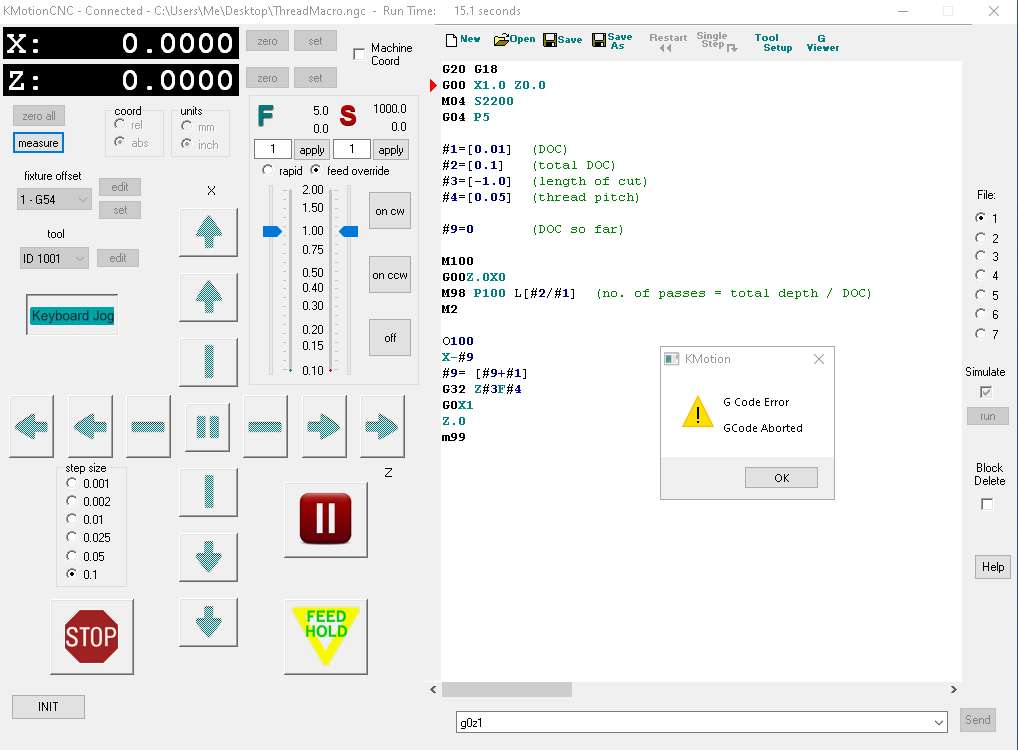

hmmm, did some manual Z axis tuning and are looking nice
i try and MDI command a 1" move to check for how close it will get but it gives me an error?
when i try and just "run" button my threading code i get the same but with white encoder counts.
not sure what is not complete?

my step increment buttons dont do any movement too?
jog does fine....
i bet i am about to be learned! :D

Posts: 2901
Post by TomKerekes » Sat Nov 18, 2023 6:38 pm
Your Spindle Axis #2 should not be included in the Coordinate System.
Post your \KMotion\Data\GCodeConfigCNC.txt file or Tool Setup Screens so we can see your Configuration
