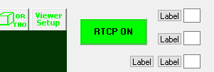

Sorry for the delay we made some changes to facilitate doing this and to make other things easier. Unfortunately it involved quite a few changes.
Here is the result:
A new command was added to read the Tool Number and ID from the currently selected tool table entry.
KflopToKMotionCNCFunctions.c added GetToolSlotAndID(int *Slot, int *ID)
PC_DSP.h PC_COMM_GET_TOOL_SLOT_ID added
Host Status updated in KFLOP now has a new status whether RTCP is currently active HOST_RTCP_ACTIVE_BIT. RTCP_ACTIVE defined in KMotionDef.h to access that bit.
KMotionDef.h
KMotionCNCDlg.cpp
Screen Scripts now allow Control definitions to be incomplete (missing parameters) and allows parameters in any order to make it simpler to change Text or Colors of controls. Unspecified parameters will be left unchanged. Controls will now be redrawn whenever their text changes.
KMotionCNC.exe
Unibutton.h
Screen.cpp
For example ChangeRTCPon.scr contains
and ChangeRTCPoff.scr contains
An example Screen RTCP.scr has a button IDC_But11 for displaying RTCP Status and with an Action when pushed to change RTCP State by setting Virtual Bit 1200.
RTCP.scr
KFLOP C Program example to continuously update Button status and to change RTCP state when requested by Virtual Bit 1200
UpdateRTCP_State.c
Patched files for Version 4,35f are located here.
Please download and copy over existing files. Let us know if you have questions or any issues.
SubScript
ID:IDC_But11,Bold:1,Colors:0;00FF00;;,Text:RTCP ONCode: Select all
SubScript
ID:IDC_But11,Bold:1,Colors:0;FF8000;;,Text:RTCP OFFRTCP.scr
UpdateRTCP_State.c
