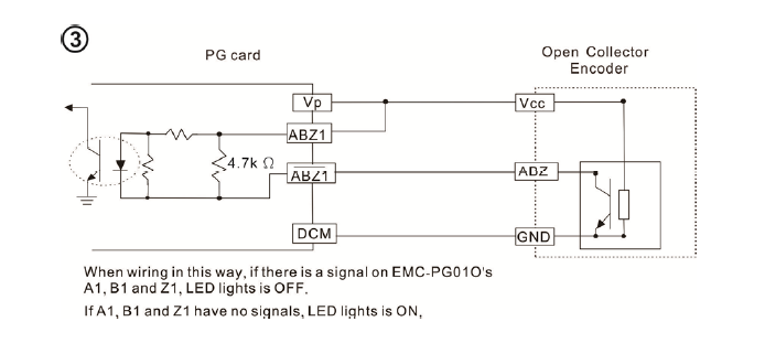

So I had a look at the pulses in KMotionCNC, it was constantly moving even with spindle stopped, kept investigating, as soon as I plug in the JP5 it starts counting, I guess from noise issue, movie available here :
https://drive.google.com/file/d/1jYrcrF ... sp=sharing
And the way the encoder is connected attached, A B Z going in parallel to the feedback card and to JP5.
Any suggestion?
Cordially
Francois

You should use differential signals in noisy environments. Consider adding a 3rd party differential Driver. This can also be used to create 2 single ended signals (the + and - signals) with higher drive than simply a 4.7K pull up.
It seems like your cable is unnecessarily long.
Paralleling the signal is not a good idea.
Its not clear if the cable is shielded or where the shield is grounded or to what. Normally its best to connect the shield to the DC GND of the Receiver (KFLOP) only.
The 4.7K pull up is very weak. What is the spec on the driver?
Termination resistance on the KFLOP end may help.
You might multiplex the Encoder Inputs from JP5 to JP6. See the MuxEncoders.c example. This will add 150ohm termination so the encoder must be able to drive this,

Cable used for the video is not the one used normally, I just picked one new for the video, same effect happens with a very short cable (40cm) and VFD not powered.
Yeah, I guessed so for the paralleling, I may need to find a solution there.
Grounding was done on the COM of the 5V powersupply (which powers Kflop), I can change that.
Which spec do you mean Tom? (not really sure, they also suggest : 5V Recommended pull-up resistor: above 100–220, 1/2W)
Do you mean a pull-up resistor per phase very close to the Kflop?
By multiplexing the encoder, you mean having in parallel the A B signal to 2 encoders channel then the code would make one filtered out of them?
I need to make more tests on it, but using ch2 encoder is ok (not needed for something else). Big question is why it works very well (so far) on JP7 and very noisy of JP5?
How much current the encoder output can source/sink. If it it open collector then it can't source any current. Normally an output can actively source current so a 120 ohm to GND at the receiver end will reduce reflections and ringing. I suppose with a 120 ohm pull up resistor to +5V at the encoder end and a 120 ohm resistor to GND at the KFLOP end the high voltage will go to 2.5V which is sufficient for KFLOP.
I was thinking termination (pull down resistor)
No. Multiplexing just switches the encoder inputs from one connector to the other. The advantage of JP6 might be a GND on that connector and also the built in 150 ohm termination.

No idea how much it can source, I could not find it in the specs.
Concerning noise issues, it worked on JP7 until VFD is powered and driving the motor.
So I followed your advice and grounding is done on JP7 GND, it improved significantly the noise reduction, but still not enough. I so changed the routing of the encoder cable and connected it directly to JP7, that works fine, but now VFD has no encoder feedback.
In order to keep the signal clear, I was thinking to send the encoder signal to the VFD via JP5, is it possible?
Cordially
Francois
Not really. There isn't a means of routing fast signals through KFLOP from one connector to another. I suppose you could measure the frequency coming in JP7 and command a Step/Dir to output Quadrature at approximately that frequency on JP5. But there may be a delay and you'd be making things unnecessarily complicated. I'd suggest what I mentioned earlier and add a differential driver to the encoder. A differential driver provides basically two single ended outputs. Run one to the VFD and the other to KFLOP. One being inverted wont matter.
